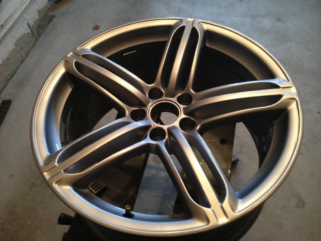

    I repaired a set of my own rims. One was badly mashed up, and the others has some small curb rash.
    I got the rim Kit from duplicolor, paint and clear coat. It worked out pretty good.
    As rick said, They do collect dirt and brake dust easier than before, but....
    Anyway, for the curb rash, I sanded down the curb rash till smooth, then filled with bondo, Sand till baby smooth.
    Then, I mask off what i didn't want to get primmer on and began Painting.
    After the primmer dried, wet sanded and masked off again what I didn't want to paint.
    Pained only the damaged area.
    Once it dried, I removed all the masking, and wet sanded the entire rim.
    Did a small blend coat of paint, and clear coated the entire rim.
    Wet sand, buff, polish, whatever you got to prevent brake dust.
    Images show the ones that the whole rim needed to be painted, but you get the idea.
    Before...
    After..

    looks good, problem with the rotor wheels, you cannot paint the lip, so its hard to use any type of filler. and if you sand the lip, you dont get the machined lines.
    Ah, good to know. I don't own a set of rotor wheels. My apologies for posting bad info.
