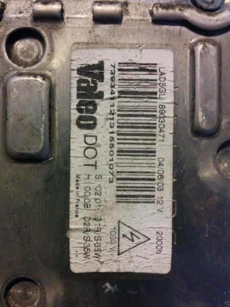

    Looks like I may buy myself some new bulbs for Boxing day on ebay/amazon.
    Anyone have any good product reviews form certain sellers?
    My basalts say D 1R/S
    D 2R/S
    Does the S: and H: before the numbers denote something, like projector or reflector? (something tells me I read this somewhere before)
    2004 A4 Avant Quattro. (H&R springs, S100 Nav unit, Neuspeed Cat back, Torque solutions Snub mount, Thor Skid Plate, APR Stage 1, 18" S4 Rims, 2X Podi / Oil Press / Oil Temp / Boost/VAC, Full LED interior, Backup Camera/Screen, Upgraded 2.0 Coil Packs, Vag-Com, B7 Center console/B7 Hand Brake, B7 Aero wiper arms B7 rear headreasts,APR Carbonio intake, Fan washer sprayers,
    2014 VW Tiguan. (bone stock)
    Jun 27 2011
    77478
    All xenon headlights for Audi are projector.
    My .02? Get some morimoto 4300K bulbs. I have a pair in my b7 and they're excellent.
    -CP
    2008 2.0t S-Line Ti 6MT Avant
    2017 Q7 3.0t
    Former USP CLUB MEMBER #136
    Veteran Member Four Rings Luxus Panzer's Avatar
    Apr 15 2014
    187873
    B6 A4 Avant, B4 90 Sprot Q, B4 90 FWD, 2014 VW Tiguan
    Ottawa/Gatineau Canada
    All xenon headlights for Audi are projector..
    Agreed, however, this is a picture of the ballast. I think that these ballast can drive either a D1 R/S or a D2 R/S
    when ordering bulbs, I do not know if the D1/D2 denotes reflector/projector..... or if the R/S denotes reflector or projector...
    EDIT... here is a great read on Xenon bulbs and what all the above stuff means...
    https://www.diodedynamics.com/suppor...the-difference
    Sooo....
    " "S" is only to be used in projector headlights. The "R" is only to be used in reflector headlights"
    Looks like I need "S" , but do I need D1 or D2... they are totally different, D1 has an igniter attached.
    If I had to bet, I would say I need a D1S bulb

    D1s.
