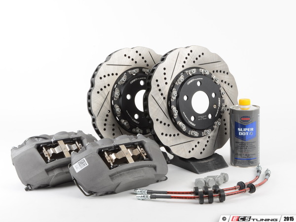

    If you cross-reference the Toureg fitment for pads there are a number of options, including:
    Pagid: 1977740
    EBC Red: DP31908c
    Hawk HPS: HB632F.586,
    And a whole host of track pads from Hawk: HB632N.586, HB632Z.586, HB632B.586
    There are loads of others as well and these pads all appear to have the notch for the wear sensors.
    The Caveat is that the pad dimensions APPEAR to be the same or very close but there is some variation, often by only a few tenths of a millimeter. The main difference being in the pad thickness which could mean that some pads are too thick.
    Centric lists their specific pads for the Q5 Brembos as measuring 131.8mm wide x 77.5mm high x 15.8mm thick
    The Brembo RS3/TTRS/Touareg pads are listed as: 131.6mm wide x 77.3mm high x 17.1mm thick
    Hawk lists their Touareg pads as: 131mm wide x 77mm high x 15mm thick (These numbers seem rounded)
    I still need to get a set of calipers and measure the OEM pads that came with my Q5 calipers but I may bite the bullet and just buy a set of Hawk pads for the Touareg and see if they are indeed compatible.
    In looking through pages of pad shapes and sizes for Brembo calipers, I also just discovered that the 2010 (And probably other years) Subaru WRX STi also has the same pad size and shape as the Q5 Brembo pads however these pads don't include a notch for the wear sensor. It does look like they'll fit though and offers another huge selection of pads possibilities.
    I'll do some more research but looking promising for these calipers!!
    Here are pad diagrams from a few manufacturers for comparison:
    Centric direct replacement pads for Q5 Brembo Calipers:
    Brembo RS3/TTRS/Touareg pads:
    Hawk Touareg (And apparently Corvette) pads:
    And the Brembo Subaru WRX STI pads:

    For the interest of anyone with this setup, I was able to track down a set of WRX STI pads from a NASIOC forum member who was kind enough to send me an old set.
    In comparing the pads side by side they are virtually identical, only major difference is that the Subaru pads don't accommodate a wear sensor.
    As far as size goes, the backs are identical width and height-wise. The Subaru pads have a slightly larger hub radius cutout but barely. I test fitted them in my calipers and they seem to fit perfectly. Being as these pads are super worn, I can't road test them but I don't see any reason why they won't work. This opens up a huge list of pad options for thee calipers!!
    Pads were from a 2010 Subaru Impreza WRX STI.
    OEM pads on top in pics and STI pads on the bottom:

    OEM Q5 Brembo Brake Upgrade Review
    Yep- good tip. These use an incredibly popular pad.
    It's also used on the CTS V, Camaro SS, Evo X, STi, Aston Vantage, TTRS, R8/GTR rear caliper, etc...

    Will these even fit my VMR V708 RS4 19x8.5 +38 with a 5mm spacer?
    I also understand we don't need carriers for these?
    What did you guys use to plug the pad sensor connection since these new pads don't have them?
    https://www.ecstuning.com/Audi-B8_S4...e_2/ES2730473/
    https://www.ecstuning.com/Audi-B8_S4...e_2/ES2856005/

    They bolt straight to the uprights. Just like 17z or 18z to B5, B6, B7.

    Will these even fit my VMR V708 RS4 19x8.5 with a 5mm spacer?
    I just zipties the old sensor onto the spindle...problem solved

    Thanks! I'm asking if they will fit and see if anyone has the same size rims as me since I'm not home to measure with the template. I want to order before the sale is gone.
    Edit: They will fit and the sale is going on for the calipers until Jan 3rd.

    For those needing to know if this kit will work with there wheels we do have a template available for you to print out.
    Click HERE

    Quote Originally Posted by The Infiltrator View Post
    You can get Touareg front pad wear sensors that will fit the pads and they have the same plug end. Or ECS sells plug caps.

    Rear calipers are the same, just need the carriers and rotors...

    Quote Originally Posted by poweredbyaudi7 View Post
    I know, that's why I just want the carriers and rotors. I have been looking for the rears for a while and hoping some one PM's me with a set.
