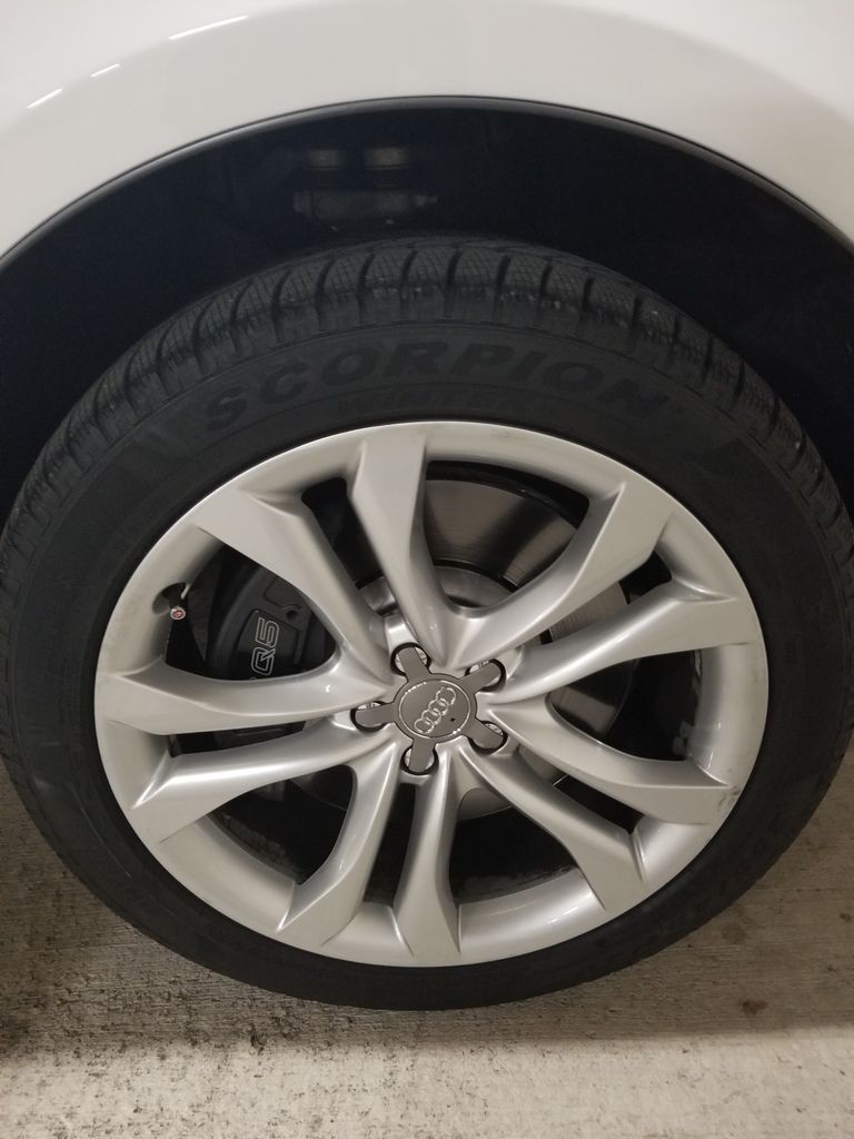

    Here's mine. 20x9 ET37 S-line split wheels with 255/45/20 Pirelli Scorpion Winters. Good inner clearance with no spacers.

    Pirelli Scorpion Winter is a great tire, recently bought a used set with 7/32 (new is 11) and with last nights/this morning blizzard they still grip amazing on ice, hard packed snow, hard slush etc. There is Pirelli Scorpion Snow & Ice as well, not sure how they perform though.
    Would 235/45/21 fit the new SQ? If not sticking with 255/40/21 is always an option, just the price for 21's winter tires is insane.
