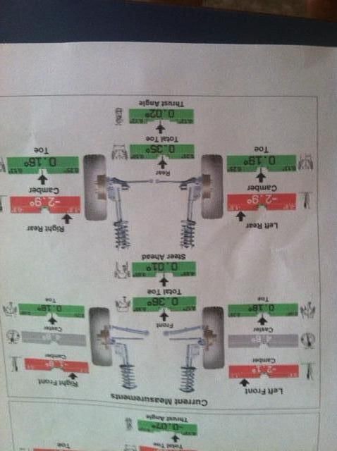

    Encouraging news. I drive 400+ miles per week. Think my tires will last past Labor Day? [IMG][/IMG]

    Being your car is riding on it top, your tires should last a veryyyyy long time
    Ha sorry for the upside down pic. You get the point though. Camber is...ehhh but toe is in check
