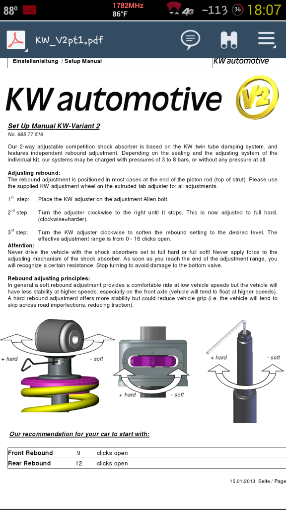

    Who here is using KW V2's? What are your rebound settings? im getting ready to install mine and theres 18 clicks(notches) for rebound adjustment, but the kw pdf and customer service at kw swears theres only 16. so customer service says "if i have 18 clicks, the last 2 are unuseable". so i ask is would it be the 1st and last click, or the last 2 clicks counting from full soft or the last 2 clicks counting from full hard? they reply refer to the pdf file i sent, but it specifies nothing of the sort.
    Next, the recommended settings to start with say 9 clicks open in the fronts, and 12 open in the rears. I ask 9/12 clicks open from full soft or from full hard. they reply from full hard. i said are you positive that its not from full soft? that doesnt make sense, even though the car is front heavy, why would the car be softer in the rear if the car is prone to understeer? my other KW V2's were installed by a shop and they said the settings were neutral in the fronts, and +1 hard in the rear and handled like a champ.
    im putting these in myself and dont want to put them in, only to take them out again if its adjusted wrong and rides like ass.

    they are indeed only rebound adjustable. less rebound would be more of a comfot ride while less stable at high speeds. if I were able to figure out exactly what the settings were before I sent them for warranty replacement, I can set them and not have to take them off for adjustment.
    http://kw-suspension.com/us/kw_variant_2.php
    as far as their recommendations, its seems backwards to have the fronts harder than the back. my old setup had the fronts at neutral and +1 stiffness in the rears. they call for 9 clicks on the front and 12 on the rear. someone at kw said the clicks are from full hard, whi h sounds hard to believe. it would make more sense if the clicks were from full soft as that would make them a tad stiffer in the rear helping create some oversteer and helping with the weight transfer while cornering.

    zillarob, how can it not matter which end I count the clicks from? if I do 9/12 from full stiffness, it would be 43.75%/25% stiff. if I counted 9/12 from full soft, it would be the total opposite and give me 56.25%/75% stiffness...thats a hugh difference.

    above pic in 3rd step is supposed to say counterclockwise. not sure how KW proof readers missed that. lol
    so can anyone confirm if these 9/12 clicks are from full stiffness (closed), or from full soft (open)? the pdf just says 9/12 clicks open. they should have specified by saying "from closed" or "from open" but I guess thats what happens when they translate from German to English, words get lost.
    I know the front of our cars are heavier, but 9/12 clicks from full still would mean about 43.75% stiffness in front and 25% stiffnes in the rear. dont think that would help with the horrible understeer these cars have.
    I would call the shop that set my old V2's up and ask them(R&A Applied Arts in NJ, specifically Andy King), but they been out of business for years
    EDIT: now that I think about it, 9/12 clicks open should mean exactly that, 9/12 clicks from full stiffness (closed)

    If you read the step 2 & 3, it's pretty clear that they want you to start from the full hard (clockwise).
    IIRC, your front rebound must be set before you install the shocks. If your rear shocks are like the V3, you can make a cutout like this and make the future adjustment easier.
