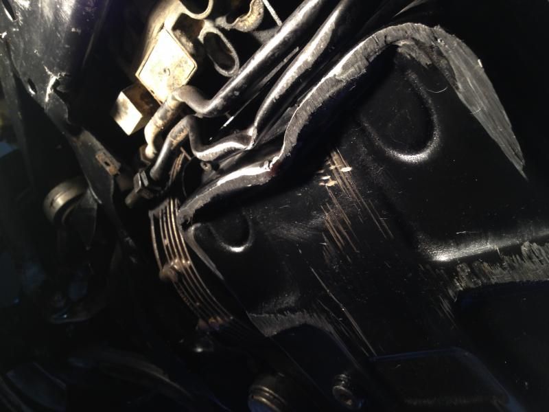

    so i bought this allroad with blown suspension and cut spring up front rode like shit so went in to switch out to a6 suspension. when i was under the car i noticed the transmission pan and tranmission cooler lines were craked and bent due to the car being so low and the bounce from the cut springs. i think the previous owner did it on the drive up as it was not "leaking" when he had it. went ahead and replaced the tranmission oil pan and filter plug engine oil pan
    so my questions is can i just replace that section of the line with a fuel line and some clamps? is it high pressure?
    i have found the whole line but it looks it insert on top of the tranny not somewhere i wanna try and sick my hand

    OEM only. Or good luck with the hit-and-miss trans cooler line fab. I think if there a way to save $5 on trans cooler lines Audi would have done it.

    You can PROBABLY replace just a section of the line to get you running till you source the full size line. I dont know how that line runs but im sure its a PITA. If you can get to both sides of the lines then I would say replace the whole thing. There are plenty of these cars being parted out privately and by parts houses to be able to get that line for a decent price. Oil pan might be a little bit of money but you dont have a choice..

    Replaced both pans already 120 for tranny 40 for oilpan . I found a replacement original line for only like 100-120 which is not bad but the access is really hard .
    Really wanna just replace that section with rubber or something but don't know enough about the fluid preaaure and heat and what not

    The problem with replacing the line with rubber (other than the obvious) is if you suffer another hit like this after (hopefully) raising the car up a couple of inches, you piss out all your oil in no time flat.
    Do it properly the first time.

    ok ill look into replacing the line but idk if its even possile with the motor in the car

    I have lines for a 5HP. But like you said getting to the connections on the trans is probably a HUGE PAIN IN THE ASS! I can take a look at my extra trans since it is out of the car and maybe I can help with some info. You may be able to remove the snub mount and worse case rear subframe bolts and prop the trans down enough to get the clearance you need to get lines on and off the trans....seems legit...lol..
    Even if it is a pain... Rollerton is right! Do it properly the first time and in the end it will be less work in the long run.

    ok yea i wasnt too comfertable with bandaid but at this point it seemed like my only option .
    i would love some guidance to see where it hooks up i seen its on the driver side ...10mm .....looks to be on the top of the tranny

    the line is cheap and easy to get ....just replacing it seem very tight fitting job lol ive done b5 s4 motor pull but with the FAILTRONIC in there its super tight

    looking at it some more i can route the new potion tucked up on the bellhousing or tranny. then if i hit ...which once i set up the suspension right wont be an issue..... itll hit the pan..... just playing with the idea of the bandage some more as replacing the line is straight forward

    I could not have replaced it by now because that means dropping the tranny for access . It's not my daily driver so I'm looking for other options thanks for your advice

    Gonna make you guys proud. Went and got new front suspension since they had cut spring up front it destroyed the shock so it needed to be replaced after using what u needed to get rid of the air ride. While I was there I took a peak at a couple transmissions and luckly found one with the lines still in tact, and also noticed a new way to get at the bolt that holds them in! Sometimes it looks impossible but there's always a nice trick or way around things in these cars. Looks like ill have to remove the axel on the driver side along with some of the heat shelid for the dp! Will update! Thanks !

    so finaly got around to switch the tranmission cooler oil feed line off the tranny. had a hard time dealing with stripped screws on the heat shield covering the cv axel. and had to trim a bit off of the dp heat shield but i was able to snake it out!
    when theres a will theres a way! thanks for everyone who convinced me to do it the right , but diffiuclut, way
