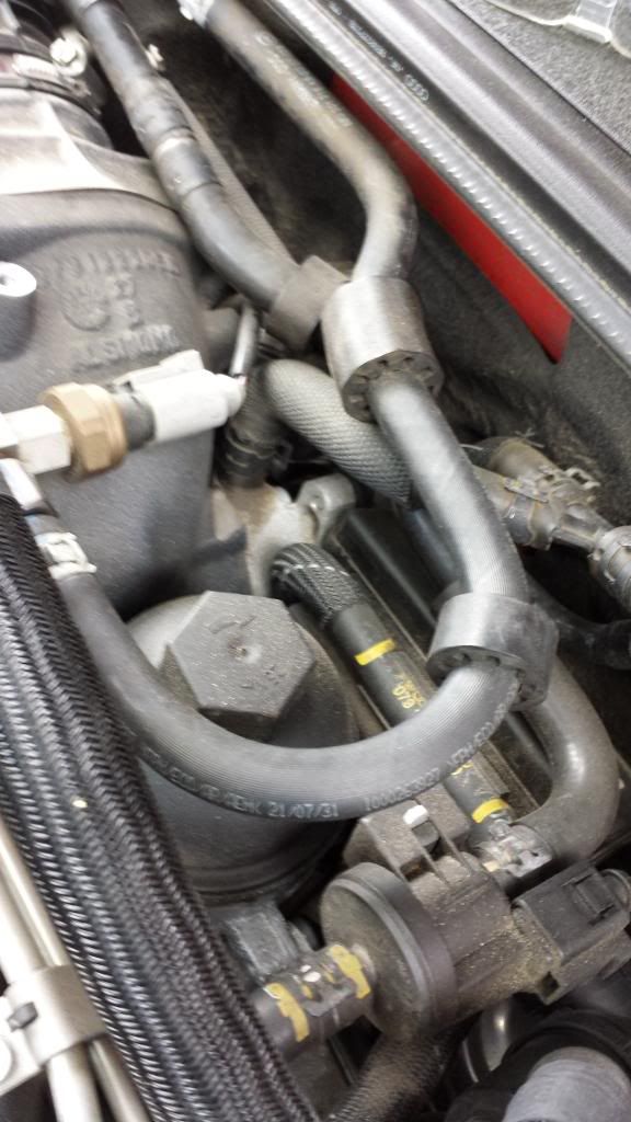

    Now it is time to remove the filter. A 32 MM socket does the trick: Yes, 32 MM. Huge!
    These hoses were in the way. You just have to bend them back a bit to get the housing out. The filter is attached (quite securely) to the plastic housing:
