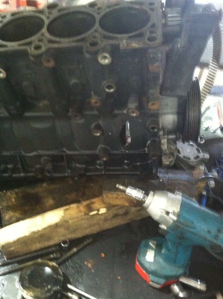

    Veteran Member Four Rings glissoar's Avatar
    Oct 16 2010
    65777
    2010 Jk Unlimited
    virginia beach
    Quote Originally Posted by Jake@JHM View Post
    Is there anyone out there that got a bent rod while running a K04 variant without being Maestro tuned? I am curious.
    I disintegrated a rod and blew a hole in my block on my K04 United Motorsports tuned, but I will say my build was used to write the original UM K04 Base file which has been tweaked quite a bit since then so you can't expect things to be perfect the first go round. Rebuilt the motor with brute rods and CP pistons and no issues now
    2008 A4 *For Sale*
    CTS K04, United Motorsports Tune, Brute Rods, CP pistons, 9:1 compression, Autotech Fuel pump rebuild, ARP head and main bolts, RS4 injectors, Custom built FMIC, 034 cat (gutted), AWE Exhaust, Stasis SS Coilovers, Stack boost gauge, Hydrographic dip trim, Ti Front Grill

    Quote Originally Posted by glissoar View Post
    Wow, it broke into pieces??
    So that is 1 person without Maestro with rod+k04 issues. Any others out there?
    Oct 16 2010
    65777
    2010 Jk Unlimited
    virginia beach
    My block can't find the picture of my pile of rod sitting in my oil pan, it literally broke into like 7 pieces
    [IMG][/IMG]

    glad you caught it in time!
    ie rods ftw!

    So shiro you engine ran like that? like you drove it around more or less fine?
    I had no idea it was like that, I don't know when it happened, it might have happened when I was stage 2+ or after KOR install, I have no clue. I've alayws had issues with my maestro tune while KOR and never had it running right but that's all I can say.

    But my car was basically running fine if not pushed hard. Lately I used to get lots of misfires at high boost and two days before I pulled the engine out the car started smoking really bad out of nowhere while cruising.
