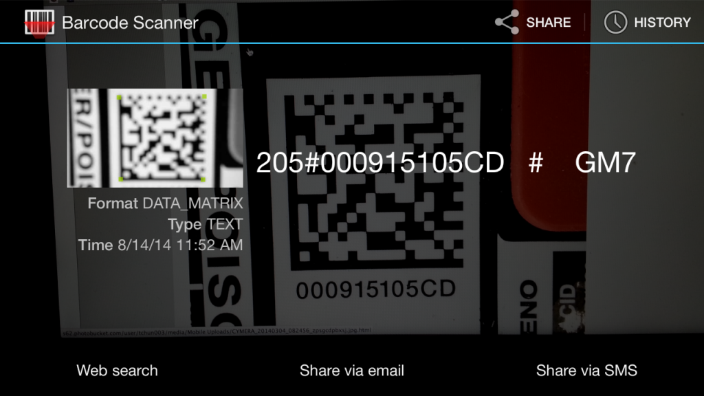

    Can you please take some more pictures of BOTH batteries.
    It looks like your old battery is a Varta but I do not know what is the model of your new battery.
    Please also take a photo of the QR Bar Code on both batteries.

    http://www.audizine.com/forum/showth...=1#post9481796
    Weird I can't seem to figure out the QR code...
    I could change the coding by 1 for the car to know it's a new battery.
    So 3D091510H JCB590116G0Q9
    to
    3D091510H JCB590016G0Q9

    Just open up that side and change one of the numbers in the middle
    So it says JCB5 XXXXXXXX6G0Q9
    Only touch the XXXX I think those are the date the battery is made.
    So the 3rd X just change it to one number less.
    So I'd replace the 116 to 016.
    that;s the safest.

    No, this was for 95ah non AGM bem code, for AGM your best way is go with BEM code for 92AH (only one closest to yours in 8K,8R,8T platform!)
    https://data.motor-talk.de/data/gall...4244728490.jpg
    How do you interpret this BEM for a date code? JCB 420412C09T
    Everything I've read suggests the first 6 digits are the date. My earlier version of that same battery is JCB 101123N08R, which apparently means 23 Nov 2010. The BEM sticker shows JCB1A1123N08R, where 1A apparently refers to the year, 10. This is consistent with the date code stamped on the -ve terminal - 47/10 for week 47, 2010.
    Confusing...
    Edit: Gunnark, are you able to post the entire QR code in the photo?

    No I cant, no full pic of this battery, but if you take other example from here:
    https://goo.gl/images/5VvstS
    You get scan and idea! But there is no need or point convert this bem code, as date is for car(energy manager) useless!
