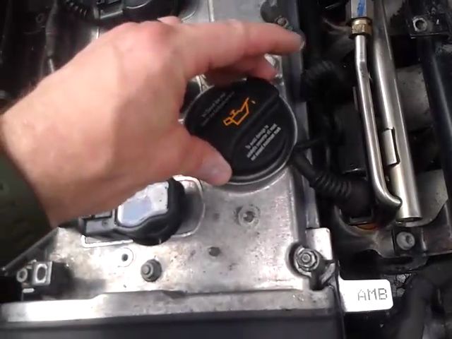

    looks like I am good :) (1.8t)
    (CLICK TO PLAY VID)
