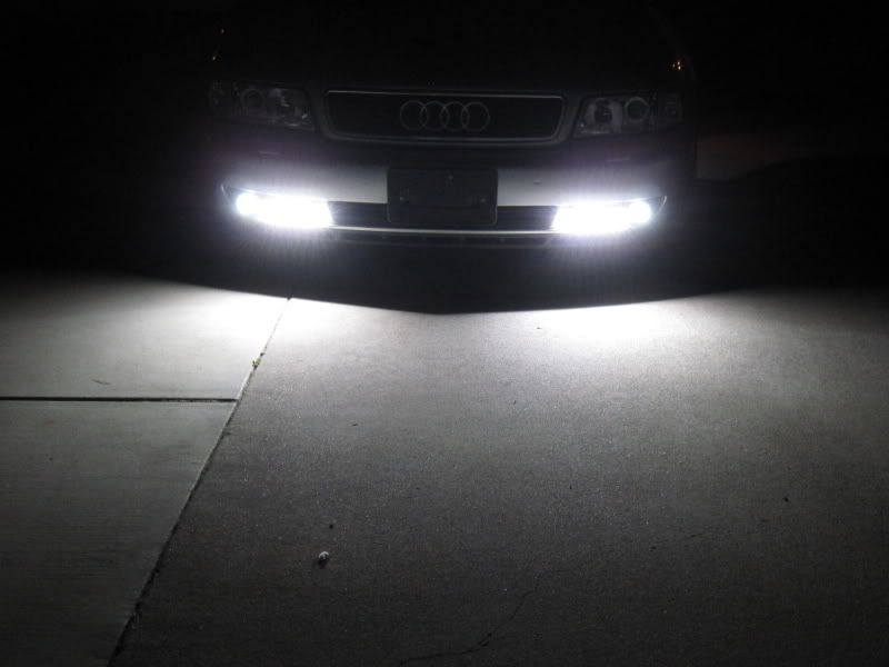

    Here's a pic of them installed, if you will ignore the LEDs I put in:
    And just for fun, the LEDs at night-time, with the camera flash:
    And no camera flash:
    I still have them, and they're just sitting in a parts bin... if you're interested I'd be happy to sell them to you for only a little more than the cost of shipping :)
    Lastly, I installed a pair of LED bulbs into the foglights themselves, as they were just too bright for my liking even with halogen bulbs. (I didn't want to be "that guy" on the road)
