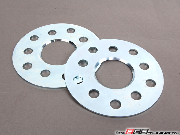

    The spacer needed to center the rotor in the caliper.
  17. #57
    Jun 10 2010
    60106
    Thickness would be helpful.
    The thickness is two posts above the picture, but I used 2mm. 3mm will also work

    Quote Originally Posted by Scotmbb107 View Post
    Where do you source these spacers? And they fit over the wheel hub and the rotor is still centered? Aka, no vibrations?

    The spacer as well as the rotor need to modified to fit the hub correctly. I have since installed mine by making very crude adjustments with a grinder. I have had a lot of trouble getting them to sit centered so I strongly suggest taking them to a machine shop and possible taking your b5 rotors an tell them to match them. They are absolutely amazing brakes, I get light headed every time I stop cuz they bite that hard. But to save major headache take them and have the modified with the proper tools.
  23. #63
    Aug 25 2012
    99295
    Elmore alabama
    And spacers from ecs tuning 3 mm would be perfect with no modification to caliper.
    3mm spacers and the correct size wheel bolts available below - currently 15% off for the holidays
