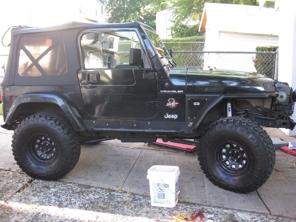

    I can confirm, I had a well built wrangler, I only used Moog ball joints. They make serious quality parts, even stronger than OEM
    Proof of said jeep:
