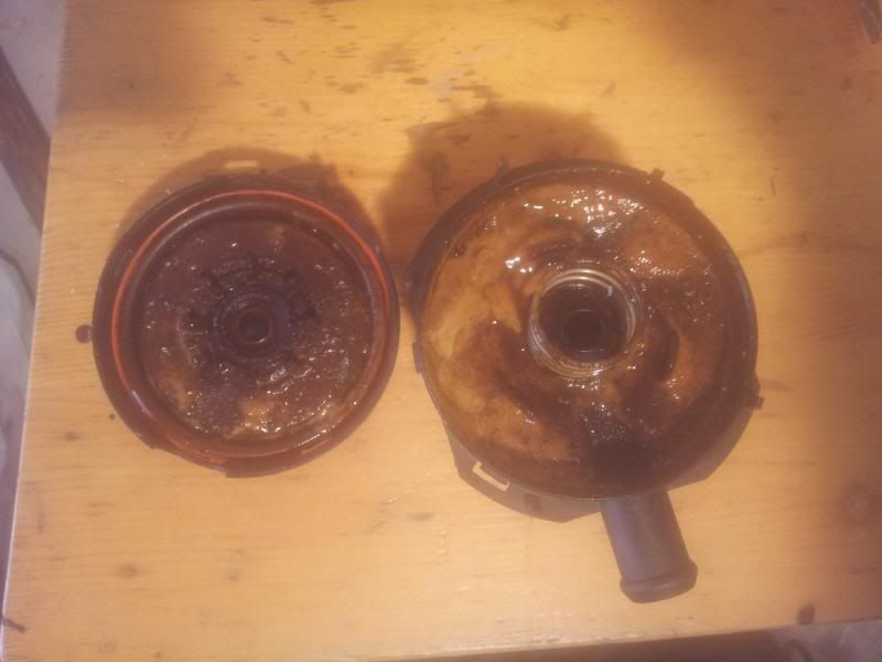

    Since the leakdown tester wont be here until tomorrow I started checking the crank case ventilation. Started with the easiest part, the pcv valve.
    Doesn`t seem to be a clog in the valve, so is it worth checking the parts of the system that are harder to get to?
    Btw, the vlave looked like this.
    Senior Member Two Rings alterdcreations's Avatar
    Apr 06 2010
    57235
    I would clean out that valve and all of the pcv hoses..it should help or at least be a start.

    Not any better after cleaning valve and hoses, and to prepare for the leakdown test i pulled coils and plugs and discovered oil on the spark plug threads.
    Will update as soon as I`m done with the leakdown test.

    That could be valve cover gaskets. Also if your PCV system is plugged, that can blow oil past rings.

    I'd address the pcv system first.. All that sludge could be the issue, when crankcase pressure increase, the additional pressure can blow oil/gas past the rings into the combustion chamber at the intake stroke. It would also register a good leak down test.

    When I start the car with the pcv valve off the car, I can hear air rushing inn to the hose that connects to the valves underside.
    And if I put my finger on it i I can feel the vacum.
    When I put the valve back on without connecting the other hose, there is no vacum from where the hose from rocker cover connects to the valve. This tells me that valve is closing on high vacum in crankcase like it should and that hoses down to crankcase is not blocked.
    Is this correct?
    If I take the valve back of I can blow through it, so its not permanently shut.
    So to me it seems like the pvc system is working like it should.

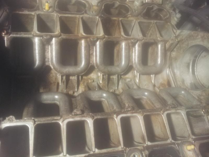

    While waiting for parts I started stripping her down today. When I pulled the top of the intake manifold there was some oil inside of it.
    Is this normal or is it because the pcv system might have been clogged up?
    I don`t want to pull the heads and change the valve seals if I don`t have to, but I also don`t want to put her together again just to find out that cleaning the pcv system and intake manifold didn`t do anything.
