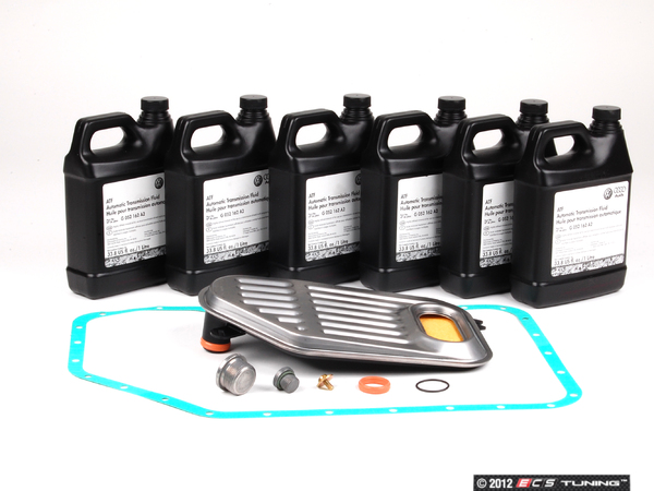

    Your PRNDS is lit up because there's no fluid in the transmission. This is a fail safe, if by chance the trans ever has a leak and the fluid gets too low it will kick it into limp mode. Which pretty much locks the vehicle in 4th gear and will not allow it to shift.
    There's a special way to fill the transmission it must be warm I think it calls for 72 degrees C. You'll want to put the initial amount in then run the trans while until it reaches the suggested temp. Once there you continue to top off the fluid until it comes out of the fill hole. You can install the fill plug once the over flow slows to a slight drip.
    It's suggested to run ATF fluid. You'll need 6 liters.
    We have service kits available below.
    Jason
