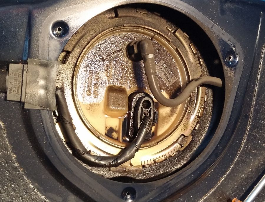

    My B6 has been smelling like gasoline each time I fill up, for several dozen miles after filling up. Since buying the car 5 months ago I've only filled it up 4-5 times so it didn't feel like a huge deal... but obviously a gas leak is a big deal.
    Finally got around to diagnosing the gas smell/leak. Got under the car and noticed that the driver-side "saddle" of the fuel tank appeared to have been collecting dirt/grime from being wet.
    Looked under the fuel tank cover on the passenger side and was greeted with this:
    It's hard to tell from the picture, but the well where the plug sits in (and the space to the left of the plug) are submerged in gasoline. Yay!
    Cleaned up the gas and looked closer. What's this??!?
    Little crack! After wiping up the tank lid I watched gas weep through the crack... problem found.
    How do you fix it?
    https://www.ecstuning.com/b-genuine-...ft/8e0201317n/
    Yep, you have to buy the ENTIRE sender for the driver-side just to replace the tank lid. WTF??!?
    Fortunately a local dealer had it in stock and price-matched ECS Tuning. I also bought the gasket, another $12.
    The tank is still full enough that lifting the tank lid / sender allowed gas to escape the tank. Crazy.

    Is this supposed to be connected or held on by vac?
  27. #3947
    Veteran Member Four Rings jpulll's Avatar
    Jun 19 2014
    256344
    Ohio

    Quote Originally Posted by Razgriz227 View Post
    connected, you need a new SJP. i have one that i can ship out to you. couple bucks plus shipping and it's yours. that or head to a dealer.
    I should add that if you need to go anywhere, you can epoxy it until you get an intact SJP.

    Senior Member Two Rings Razgriz227's Avatar
    Oct 28 2016
    384056
    Arizona
    Quote Originally Posted by jpulll View Post
    I will run to the dealer in the am and see how far they want me to bend over for some plastic, if its to much I'll shoot you a pm. Thanks for the offer!

    Jun 26 2015
    339463
    Tampa, FL
    It's $47 from ECS. So probably $150 from the dealer. Part # 058133753D

    Quote Originally Posted by rocket1420 View Post
    And $10 on eBay. :-)
