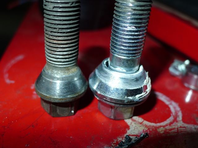

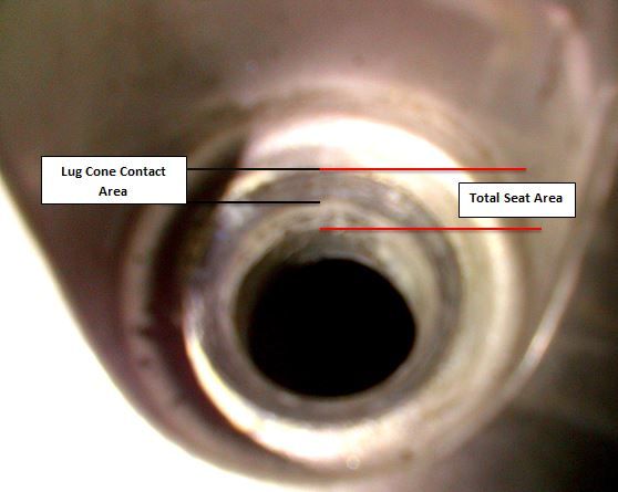

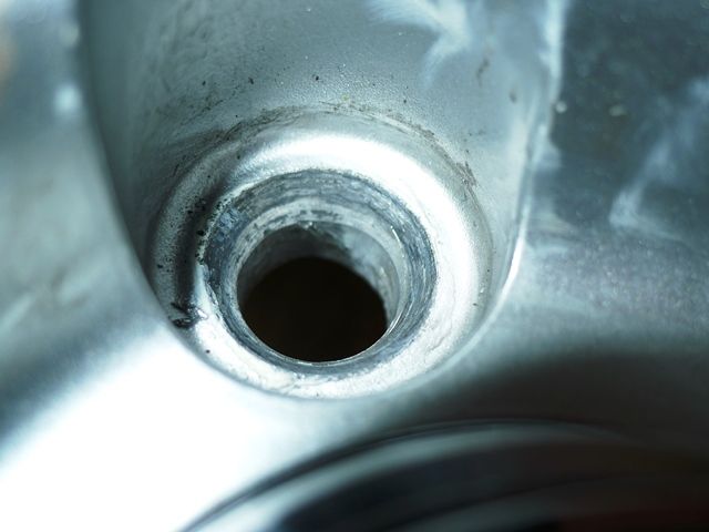

    I'm trying to install 5x114 rims on my 5x112 hub using wobble bolts. I have a set of Works rims that have a smaller bolt hole for M12 studs, I drilled the bolt hole using a 5/8 bit to give me enough room to fit the M14 bolt through and allow the wobble bolt to move around.

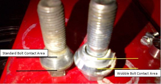

    BUT, my concern is the amount of contact area the tapered cone on the wobble bolt makes with seat area on the rim (excuse the crappy cell phone pics)
    Something tells me this isn't very safe, can anyone else using wobble bolts chime in here?
    **Added better pics**

    Looks to me like you have 2 different angles of taper on the bolts, causing you to have a much smaller point of contact.

    Checked that already... both at 60 degrees
