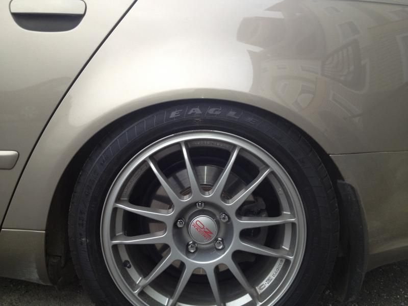

    really strange, it is very dependent on the car. I threw my st rears all the way down on initial install and the rear wheels just disappeared before they were settled I could almost cut the lip of the rim on the stock 17s and had to raise them, such a pain in the ass. 24 3/16's front and 24.5" rear fender to ground atm

    when you say "down", do you mean the knob that you turn? Because to lower the car, I have to make mine go "up" for the rears. That's strange yours goes down to lower

    Yea I meant spun up. Installed them all the way up and I would not have been able to drive it out of the alley

    wow that's strange, mine are maxed and still aren't nearly low enough. i can still squeeze a finger in the gap, no tucking for me. My tires are beefy too. 245/40'/18
    what size tires are you running?

    stockers, 235/45/17's ill snap a few shots and throw them on a bit later tonight, see if i can get the spring perch in there aswell. St's are from the fifteen52 sale

    back with pics best I could ignore the dirt, there is about a half inch or so left on the rears, though it actually drops the car a bit extra from the design of the suspension travel

    I appreciate the pics
    that's not too far off I guess from what I thought. I was thinking you had your tucked like RAaudi's pics. Still, very impressive on stock tires. I wonder if my ST's were installed in their perches properly
