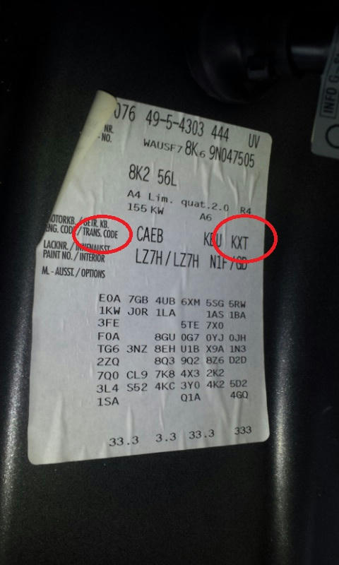

    Here is how I went about checking for the right trans fluid, you can also look at a tag on the transmission itself. This is for automatic fluid which seems to be a little more particular. I figured since you're changing the filter you have an automatic.
    Below is the RPO sticker I located on the underside of the spare tire cover (I think that's where it was):
    After finding KXT, I then checked out the column titled "Letter Code" at http://www.tsgparts.net/index.php?p=...ge_id=a4_trans and found 6HP28AF for "Trans Type" in the same row.
    Then I went to https://serviceline.zf.com/interoele...011_en0700.pdf and used 6HP28AF to find G060162 A1 / A2 / A6 ATF as the trans fluid. The A1/A2/A6 are just designations for the product size (qt, gal, barrel, etc.) Also make note that 6HP28 is not the same as 6HP28AF.
    Finding a place to purchase the fluid is another matter. I've seen it range from $20-$55 per quart depending on if you get ZF fluid or buy it from dealer. There are places that claim they have trans fluid compatible with G060162, but not many have been willing to take the risk from what I've seen.
