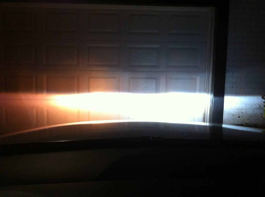

    72k miles CPO (until Sep this year) I have talked about this before. The problem is still happening:
    If I go into my car (trunk, door...) the headlights will flash on and then off.
    So far the dealer has replaced, the ECM, ignition switch, and both ballasts. I have already had one bulb go bad, I do not what to have to keep replace bulbs because of this issue.
    This is a video that I recorded and gave it to them, because they wouldn't believe me and, kept telling me they couldn't replicate the issue.

    Bad Ballasts or a sign of them about to go out. All three of my B7's have done this.

    Since the OP had his ballasts changed out, the only thing I can suggest is the actual headlight switch.
    OP, swap your HL switch with a local B7 ziner and see what happens.

    Seems a lot of people have this problem. Yes, they replaced both ballasts three weeks ago. Mine only does it if I go into the car, or trunk. I also do not lock my car as it is garaged.
    I have had to replace the bulbs already. I don't want to have to keep replacing them, as we know short bursts of use in HID bulbs, drastically reduced the life expectancy of them.
