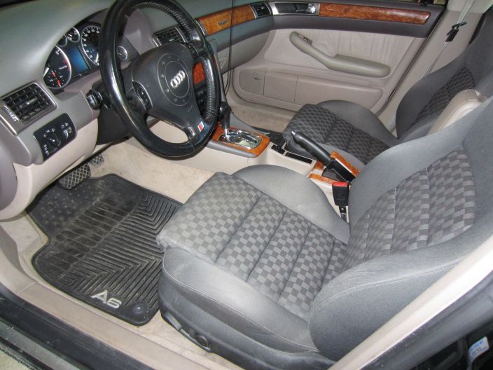

    here are my Euro sport seats I have them for 5 months now, love them very much , do not miss leather anymore..
