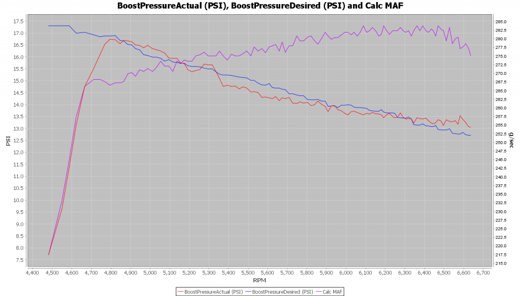

    Quote Originally Posted by rtl5009 View Post
    Hodros what kind of fats u running? Any logs I'm curious.
    I kinda F'd up the whole FATS thing but here's an idea of my boost/maf I took on way home.
    The turbo's are listed in my sig and came in a kit from AMS/ABT rated for 360bhp on all stock parts + 5bar fpr. I added the exhaust/meth but no retune because like I said I need new cats they are both throwing codes, and I can tell in my spool they are highly restrictive. I basically view my car as an incredibly strong 2+.."minus dp's" these turbo's were supposedly able to push about 16-17psi to redline and were used in a 450 bhp ABT car in 2006, so they have alot of room till they are pushed. But it is a tip..
