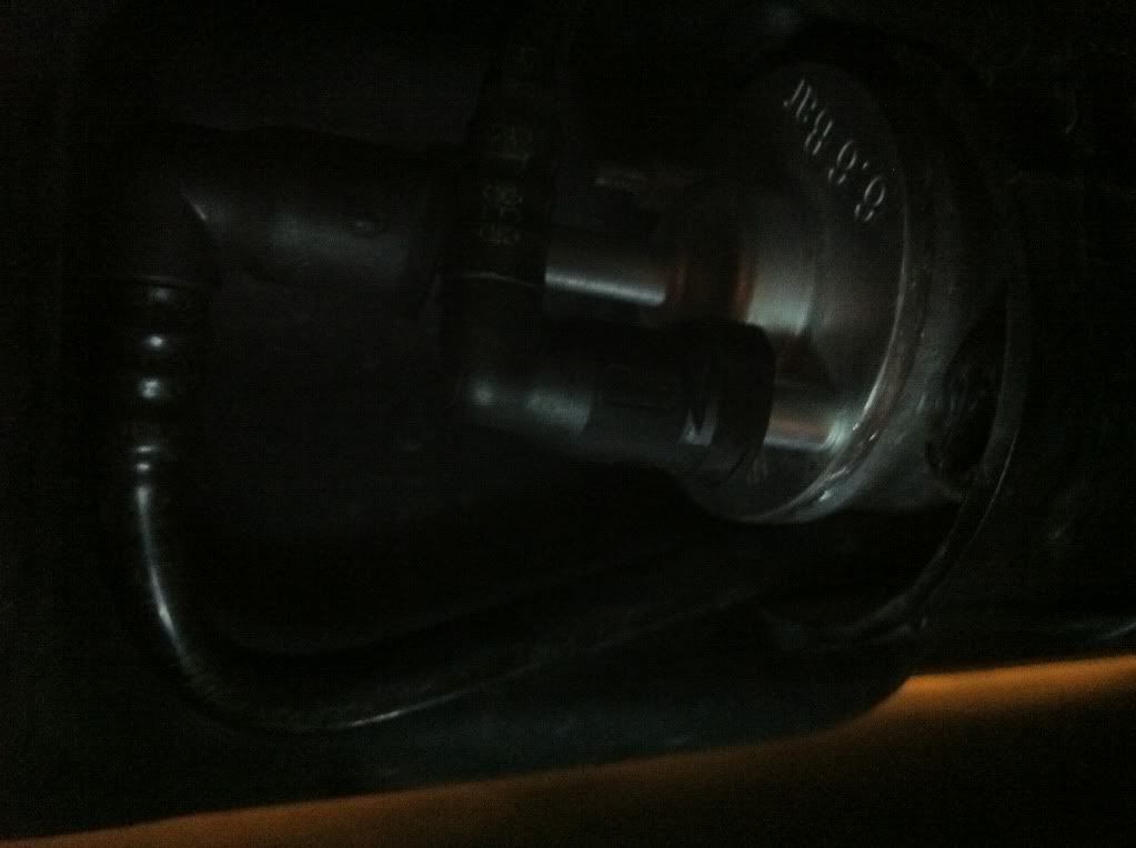

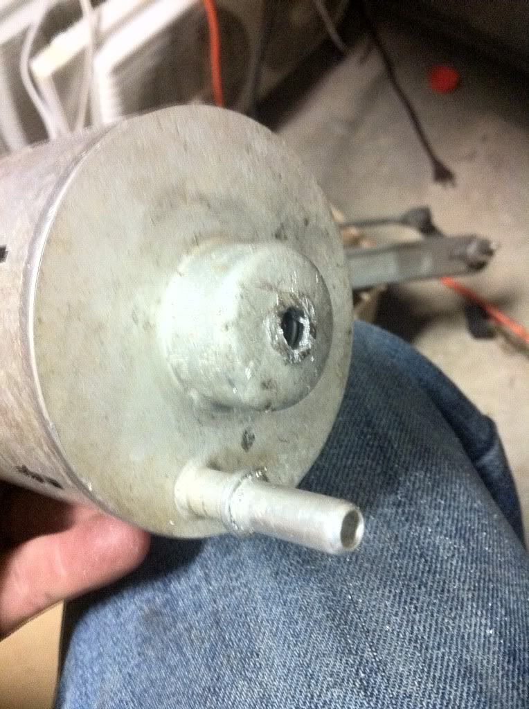

    Yes the 6.6 bar requires modification- I am running a 6.6 bar filter
    Top is the 6.6 bar
    I had to cut this off the old 6.0 bar
    Dremel'd it out, and slid it over the 6.6bar with a coating of JB Weld:
    And then it snapped in to place:
    Fuel pressure at idle:

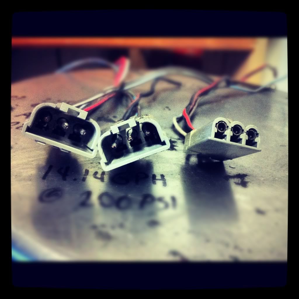

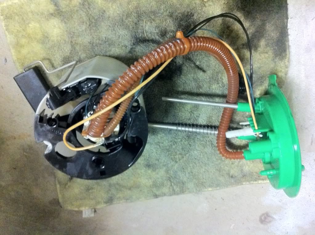

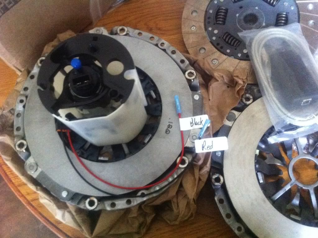

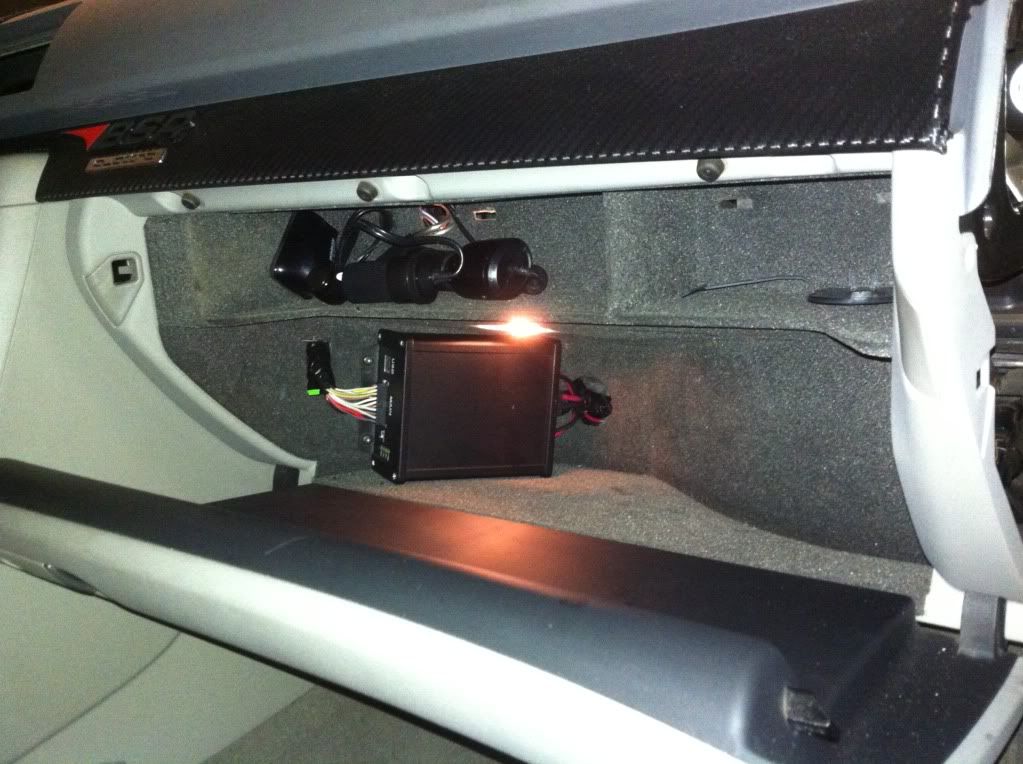

    Wiring ran to the LPFP :)
    LPFP new connection to controller!
    Got that Eurodyne Boost Manager Plus :D
    DW300 drop in LPFP
    Need to get my Eurodyne password and access back :/
    Lost my BMP program on my Pc lol
