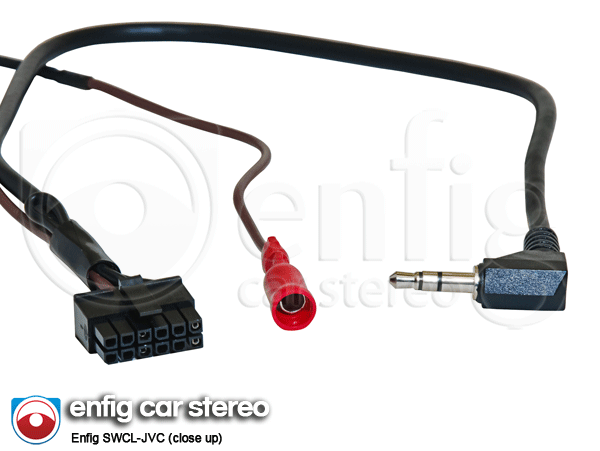

    I have this china made RNS wanna be radio (bought from ebay and big mistake) which came with a can-bus module that provides reverse gear output to the radio to activate the rear camera. I hope this harness does it as well.
    What does that brown wire connect to? What is different with this one and the other JVC control lead on your site? Looking forward to receiving the parts I ordered recently.

    We made some changes to the antenna but there is no loss of signal. The brown wire goes to the remote lead off the radio. The plug is not used.
