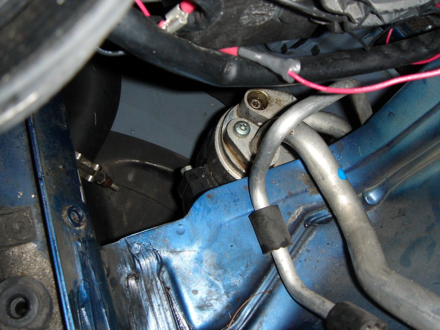

    No flight scheduled this morning so I did the replacement
    Shop was busy this morning
    Connected the AC cart to recover the Freon
    Here is the area where the orifice tube is located
    I pulled off the air filter assembly to access the dryer
    24 & 22mm wrenches to crack open the line. With small pliers, pull of the orifice tube
    The orifice tube is really nasty and I would guess 70% obstructed
    Replaced the dryer, reserviced with 780 grams of new Freon. Feels cooler already especially at idle.
    Will keep you posted
    Phil

    I presume when replacing the orifice tube you're opening the system right? YES
    So I would have to get it evacuated then refilled after replacing it right? YES
    And because the system is getting opened up, you'd have to replace the dryer as well. Not really. When a system is opened, and if the ambient air is really humid, you just need to vaccum a bit longer (I did 40 mn). My driyer was just old
    How many miles did your tube have on it? Car is 2005.5 and 120K miles
    How much would a shop charge to do a pressure test? Beauty of my work, it's all free since the shop is almost my office. I guess a full tune should cost around $80 in labor but I am not sure
    Phil
    Jun 27 2011
    77478
    Phil

    Phil, how does your A/C performs after the surgery?
    SPRINT BLUE 2007 A4 2.0T MT6 Quattro S-Line Titanium
    APR Stage II Tune (Stock, 91, 93, and valet modes) - APR Carbonio CAI - APR Snub Mount - 034 Motorsports Motor Mounts - 034 Motorsports Turbo Inlet Hose - RAI 3" HFC - OEM "D rev" DV - RS4 Rear Sway Bar - RS4 Pedals - New South Performance Vent Boost Gauge.
    Oct 16 2008
    34255
    South Florida - Ft Lauderdale
    Quote Originally Posted by lesurfman View Post
    106F in Florida today and a lot of stop and go all day. Works like a champ. Did not shut off once.
    Phil
