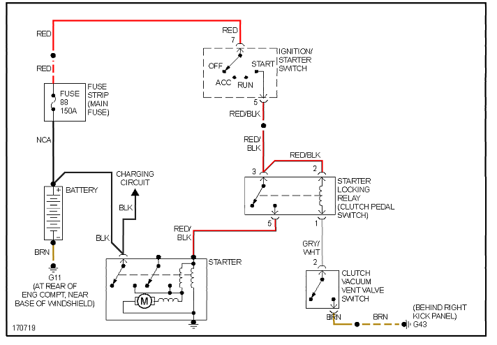

    I'm just going to leave this here:

    That diagram should help. Just swapped some wheels around so I can get some rubber mounted tomorrow (just stock 16s for now, nothing cool, my vmr's still need a refurb) and since it's after midnight already I think I might call it quits for the night/morning.
    Will check the smaller power connection tomorrow when I can get someone to turn the key for me.

    So in this image you can see the connections on the relay (top right picture).
    the large connection at 12 o'clock is the cable that is run direct from the battery.
    is the small tab connector to the left of the large connection where i want to apply power in order to test the starter? i was going to jump from the large connection to the small one but want to verify first, the small tab connector looks to have something connected to it which is why i am assuming this is the one.

    YES. If you jump the (+) power from the battery cable to The connection at 9' oclock it WILL ENERGIZE THE STARTER!! It's the CRANK signal from the ignition switch So, for gods sake make sure it's in NEUTRAL!! The other is probably a (+) for some accessory/ power on certain models.

    ok, have voltage to the terminal at 9 o'clock, and jumping it from the battery connection doesn't do anything. Napa said they can have a refurb here on tuesday for $160 so i'll order that in the morning.

    The lower clutch switch is probably faulty. Try grounding the pins and see if it will start.
    -CP

    As far as the clutch switch? Unplug the switch and connect the two pins on the harness with a paper clip. That should trick the computer into thinking the clutch is depressed and override the starter lockout. In a pinch it's a quick way to get past a faulty switch.
