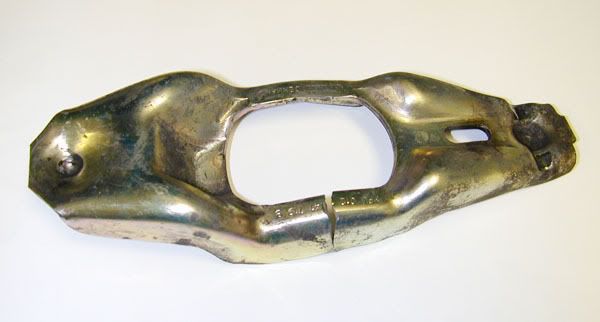

    Sure sounds familiar. I know of at least three other incidences of this happening with the SB-OFS SS: Clicky click

    I suspect your clutch disc may be coming apart. Sounds like it's time to remove the tranny. When you replace the clutch I would highly recommend replacing the fork and all associated attachment hardware due to the forces the SS pressure plate has applied to all the components.

    old guy, so I would need parts 5, 6, 7 & 8 in this ETKA diagram for the clutch fork and associated hardware?
    – Steve
    2021 Tesla Model Y
    2020 Tesla Model 3
    2014 Dodge Grand Caravan
    Dec 28 2006
    14483
    '13 A5, '24 Tiguan SEL R-Line
    Western Maryland
    Quote Originally Posted by SleeperAvant View Post
    Yep. That's what I replaced. All four parts came to $65.

    That can be a cause, but it comes down to something causing the input shaft to spin when it shouldn't be. There are a few different things that can cause the disk to drag, things like a bad TOB, a PP that is not fully releasing , the disk is not sliding smoothly on the spline of the input shaft or a bent fork which actually doesn't happen all that often on the 01A.
    Other things that can cause the input shaft to spin while pushing the clutch in is a failing pilot bearing and crank walk but I haven't seen any 1.8t's having crank walk issues.
    Creaking noise when pushing the pedal in with the motor of tends to be a bad pressure plate, a pulsing pedal is usually bad bearing pack inside the TOB.
    I have actually been battling this same issue on my car ever since I put in a new custom TOB when my old one pretty much exploded at Dubfest last year. I think my issue is that the TOB isn't as tall as my old one and not pushing the PP down far enough since the fork is not traveling as far as it used to because of the change in fork angle. I put in a brand new fork since the old one was slightly bent but it did not change a thing.
    BTW when getting a new fork it isn't really nessary to buy anything else since the plastic pivot ball and clip can be reused. Only time you would need to replace those is if the broke.
    It's alright since those little parts were literally like $2.00 each.
