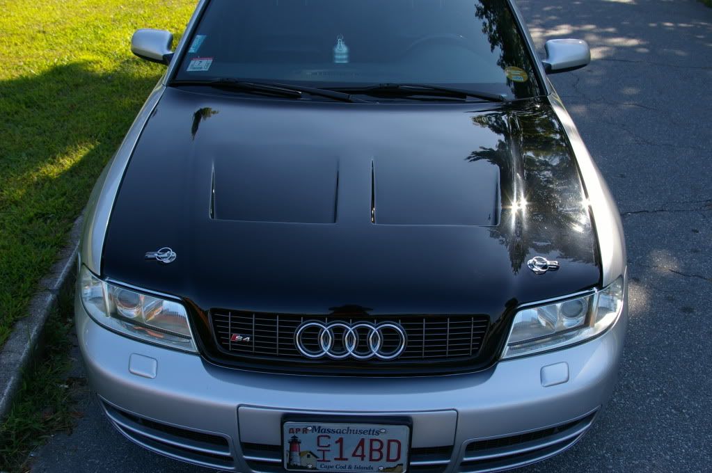

    Lock it down or loose it! Mine with Sparco pins...may upgrade soon...
    The original audikid! Coined as ebay username spring 1999.
    **MTM ECU, Piggies, ASP Tru-Duel, Stratmo ss kit, Stern sm, AWE DTS, Voltgland GT2, Neuspeed 19mm RSB, full Samco kit, drilled and slotted rotors, PODI/S-W boost gauge, Sportec pedals, 30% Huper optik, CCMod, stubby antenna, VMR 708s 18X8.5 32mm**
