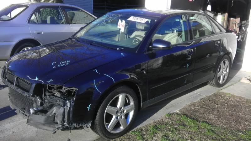

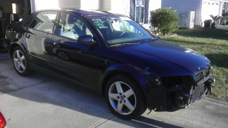

    What's up guys. I just purchased this old girl from the salvage auctions for $1900 out the gate. She has 174,XXX miles but is in pristine condition minus the front damage which isin't bad at all. Damage seems to be rad support, rad, front bumper, power steering pullet is bent so will replace the whole unit. I figure maybe 1k-1500 should get her going. AS work happens I will update progress. I'm located in Mooresville nc just north of Charlotte if anyone local wants to come hang out or help lol. I can't wait to get her on the road. It's a beautiful car and should be a blast to own. Also the car has brand new Michelin tires. Which I plan on putting rims on it eventually

    You look a little young to have a drivers licence
    Looks like it will be a fun project! GL!! Welcome to AZ

    OK got a ? so the car is a 1.8 auto swith oil cooler so this is the radiator I need right?>

    Yea that rad looks like it should fit. Theres only one radiator for the B6 1.8t so as long as its advertised to fit it should be fine. Nice pickup, and good luck with the repairs! Should be a nice DD.
    Edit: While the frontend is off you should inspect the timing belt & related components as well as the accessory belt, tensioner, etc. As well as inspect the Vac lines, and all the other bits that are a pain to access without putting it into service position. Maybe check out the thermostat as well and make sure its not weeping coolant.

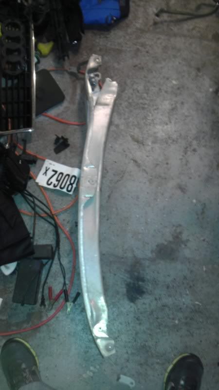

    Welp I def need a bumper support bar

    I have one to sell if you need a bumper support.

    Looks like it should be a decent car once you address the front end damage. I have a power steering pump if you're interested...even if you're just going to scavenge it for the pulley.
    Like Charles said, it would be a good idea to do a timing belt service while the front clip is off (unless you have bona fide documentation that its been done recently).

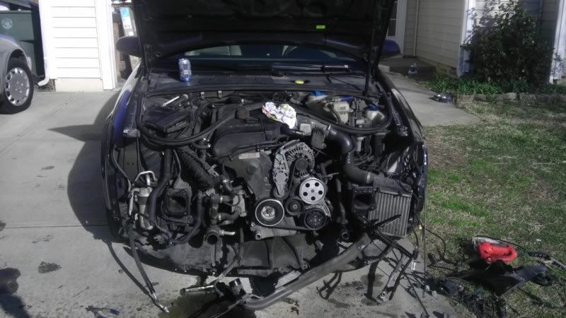

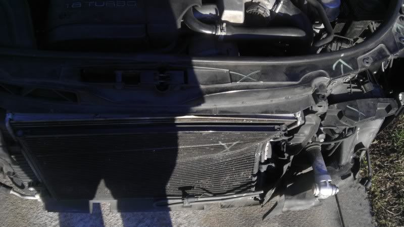

    Ok guys. Front end is completely disassemble. Ana wow that was a pain. I took the power steering pump off which required me to remove the alternator. But anyways. Now tracking down all the parts I need to fix her. Here is a few shots. Hopefully parts will come in fast as my sub division is gonna kill me haha

    is that Freeon spilled on your driveway?
    Hmm, looks kinda like green coolant...
    Also there is surprisingly little damage! You got super lucky with this pickup!

    The proper term is refrigerant lol. And no it is oil. The hose is just laying there

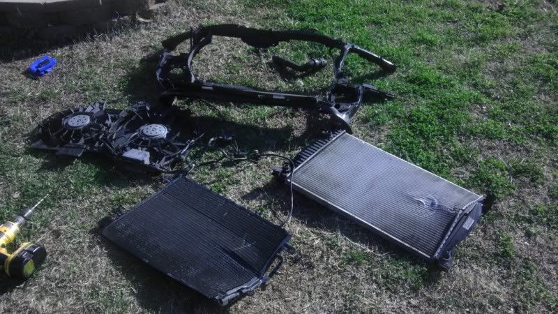

    Ok guys in the process of ordering the radiator fan assembly so thats done. Waiting on a few things to sell so I have more funds then I am ordering the radiator core support found it new for @10 shipped which isint too bad I don't think. Only a few more parts needed to order that will be needed to drive her. Getting pretty excited. I was messing around with the stereo today. I usually do really loud systems last was in my Durango 2 15: mojos 3000 rms amp 4 batteries and a huge box all built by me. But this stock Bose sounds great with the factory woofer I don't see a need to change it. Way to go Audi is all I have to say.
