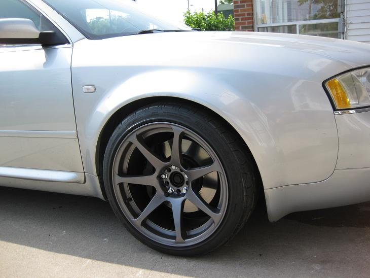

    In the spring of 2011, I finally scraped enough money together for some new wheels. On my old A6, I had run 19s and 20s. This time around, I thought I would try out an 18 in a wider size. I settled on some MB Battles in 18x9.5 with a et15 offset.
    The wheels looked great, and I had many compliments. The offset was aggressive, so I had to cut trim the liners from the front and rear fenders, and *slowly* roll the aluminum front fenders.

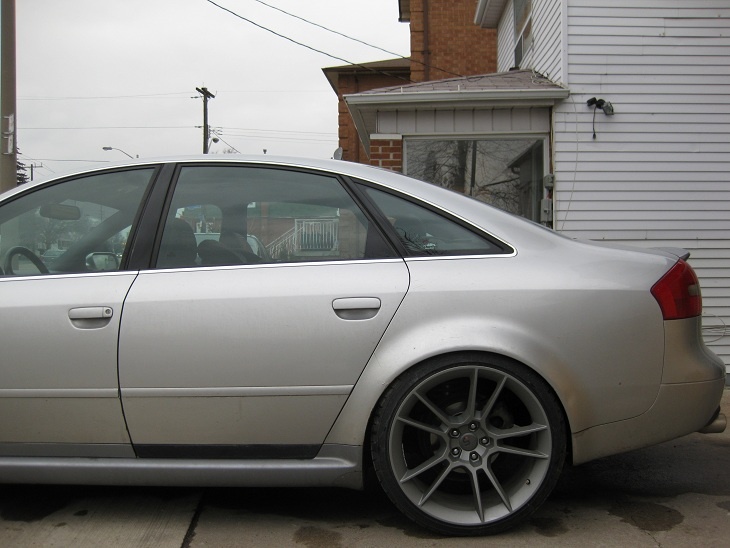

    Sneak peak of the new wheels...
    Will have some better pics once I get the height on the coilovers set. Moar lowering is needed :)
    20x9.5 et25 in front

    I've said it before, and I'll say it again.... With the right wheels, and the right drop, c5's can pull off 20's.

    Aug 25 2010
    63236
    Thanks for the comments.
    Here's a few more pics...
    Try and ignore the mismatched coloured panels :) Bodywork will be the last step in the project.
    I think the height is about right on the rear. May go a bit lower on the front.

    i like! what size tires?
    For Sale: Oem 4.2 upper and lower grilles - $100 | 0em all red c5 taillights - $100 | 4.2 rear bumber cover- $350 | Oem 4.2 sway bars|
    Aug 25 2010
    63236
    20x10.5 et33 in rear
    245/35/20 F&R
