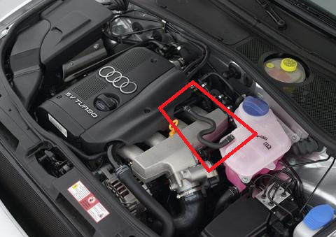

    Just got my car back from garage and they have told me my head gasket is fine BUT they still cant seem to figure out the problem :S
    heres a similar pic of where the bleed valve is located, the difference is my car does not have the screw.. mine has a small nozzel with a cap/stopper/ (what ever u want to call it) tightened with a hose clamp!
    http://www.dantesgiftbaskets.com/coolant/DSC03171.JPG
    My point is when my car is running hot should i not get a constant flow of coolant flowing out the bleed valve??? im getting steam and drops of water!! There obviously is no flow and causing a air lock :S

    I still don't know what you are talking about with the bleeder. I think something is wrong there. The only thing you should have on the top hard pipe is a hose that connects to the expansion tank. Like this:
    If that's not what you have, post a photo of what you do have.

    http://www.audizine.com/forum/showth...at-Replacement
    check out the first pic... exact same engine! bleed valve next to the dispstick. Il put some pics up 2moro.
