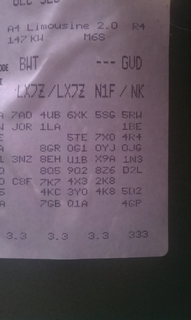

    sounds like our cars are the same.
    2008 A4 non-S Line with Sport Suspension.
    Go look in your spare tire well for the options sticker. Code 1BE indicates you have Sport Suspension.
    1BE Sport Suspension - Sport alternate suspension; Excludes: [WQB] S line Sport Package
    Note that S Line cars cannot add 1BE since it is already included:
    WQB S line Sport Package - Front and rear alloy wheels with 18 inch rim diam; Front all seasons tires with 235 mm tire width, 40% tire profile and Y tire rating; Sport alternate suspension; Sports pedals; Wind deflector behind seats; Excludes: [WPX] Premium Package And [HK5] 235/40R18 Summer Performance Tires And [1BE] Sport Suspension
    This is mine:
    Good luck. I hope you get things worked out.

    Thanks Ken! You are the man for bringing this to my attention. Here is an image of the sticker in my trunk:
