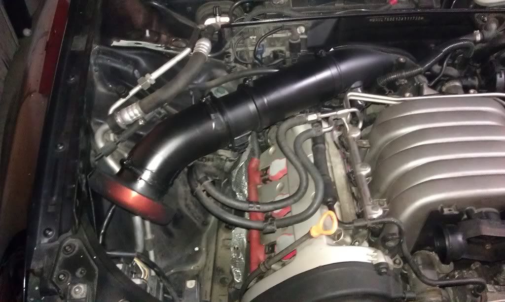

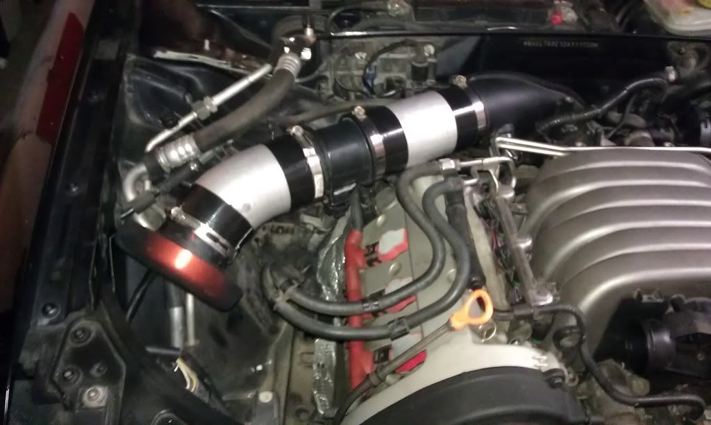

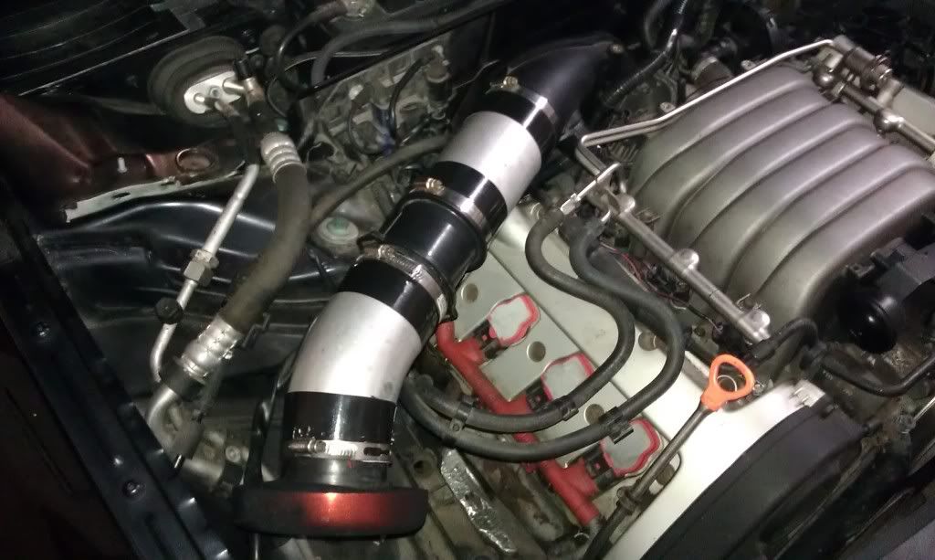

    ok keepin the progress goin.....Just did a little project my buddy had some left over 3.5" aluminum intake pieces that he gave me. So i thought hey lemme try a lil custom partial intake setup. Did a little of this and a little of that and it came out pretty cool! . Gave it a semigloss blak coat i dont like to be to flashy. Butt dyno says the low and mid range could have pikd up a bit. Did a few 20-55mph timed runs and human error is possible but i averaged ~6.5s, i used my phone so it only has one decimal place. I gotta start using my chronometer that has 3 decimal places lol this is gettin to tedious.

    Do you seriously run without a filter?

    Human error. It has been scientifically proven that an open air element in our car decreases performance.

    So when are you going to test the stock air box......I think you will find it will improve.
    I have one question with the setup you have just made, where is it getting cold air from

    Quote Originally Posted by Lout Jnr View Post
    Looks like unfiltered, hot engine bay air. Way not cool.

    Quote Originally Posted by vteckiller2000 View Post
    Nope no filtr, jus some unused pantyhose lol, believe me if u saw the inside of my intake manifold and how its caked with oil and grease u would freak, n tht was done by the previous owner, so i dnt wanna create nemore restrictions with an air filtr, ye its crazy but oh well

    Quote Originally Posted by A-FourLO View Post
    If you look in my thread, I actually ran an open element filter in my car for months, an swore it wasn't hurting the car. I went to the track and ran my set up vs a slightly modded stock air box. Ran a 16.7 @ 85 mph, put in the stock box and ran 16.3 @ 87. I swore by my set up and even stated that unless someone could prove that it wasn't helping, I would leave it in. With your intake Mani & open element filter you are only limiting your car more and more.
    My opinion is get a stock intake and fix your intake mani problems. You can't progress in different areas to make up for problems in other areas.

    Quote Originally Posted by Zingo_310 View Post
    I understand and i agree with you i need to do some more tests to see where the problem areas are, and i already know the manifold actuator is necessary however the reason behind why i need it is more intriguing to me. The actuator switches from the longer intake manifold runners to shorter runners. So given that info and what i learned from removing the actuator is look at the dyno graph and how the power carries to redline. So i want to try to replicate that effect without the actuator actually being in the manifold. Usually this means attempt to make the short set of runners a bit longer and/or make the intake tube longer. Doing it differently than the actuator could possibly give me gains in other areas along with the desired effect of the increase in torque that i was looking for. A pain in the ass i know but thats how i learn things.
    I will test the stock airbox in time. However the reason as to why the stock airbox you say "performs" better is the answer i want to find out. Becuz clearly that thing is restrictive as heck. No one in their rite mind uses a design like that for an increase in performance. So once i find a non restrictive more performance oriented design that gives the same effect as the stock airbox then i will test the airbox against it and see what happens there. IDK if you guys can see what im getting at here. I am after the REASON as to why things work and dont work. Thats what i want to learn. Not just "he said she said". Becuz yea you will learn wut works and doesnt that way but the only reason you know why is becuz this guy said this or that guy said that.

    That same box design is used in the RS4, which time after time has been proven to be better. What part about the box is restrictive? It pulls air from the front of the car, which is the coolest, highest flowing part of the car. With the air box being sealed off, all the air being forced into the front of the air box is being directly transferred to the TB. Which is why the modded box is better than stock & "CAI".
    I understand you want to find out on your own but why not take what data we already have a go from there instead of running circles around each other.

    Stock airbox is the winning choice with that motor.

    There is so much wrong in your post OP. The stock airbox is not clearly restrictive at all, in fact millions of dollars were spent flow testing it making it function correctly and well. You have NO mods which would make the stock box restrictive in any way. The stock box is good well past 12's which you are nowhere near. Also, the variable runners would actually cause you to gain back your torque you used to have, and ALSO gain the top end you got removing it. You really get to have your cake and eat it too with the stock setup which is why I am completely befuddled as to why you are doing the things you are doing. Plus, you are damaging your engine running without a filter. You are actually making your car way slower and hurting it in the long run by doing what you are doing. I am all for learning about modding, but we are all beating our heads against the wall trying to help you and you just don't want to listen... I am frustrated.

    Also, your intake manifold is most likely caked with grease and oil because the PCV system needs replaced. Do your stage 0 maintenance before modding and your results will actually mean something and be much more helpful to the 3.0 community.
