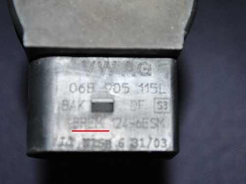

    Mine had a set replaced by audi before I got the car (like 2006 or 2007-ish), then again in 2011. I actually called Audi of America in 2009 about the coil packs that were presently failing on me and they said the car already got a replacement set under some kind of recall and I was out of luck. So I bought entire set of "R" coils to replace the crap "L" coils. Then in 2011 I got a full set of "D" coils under the campaign. Then after all of that I put in red FSI coils!
    So that's a Maybe. I think you can only get 1 set per actual recall. In my case it was 2 separate recalls I believe.
