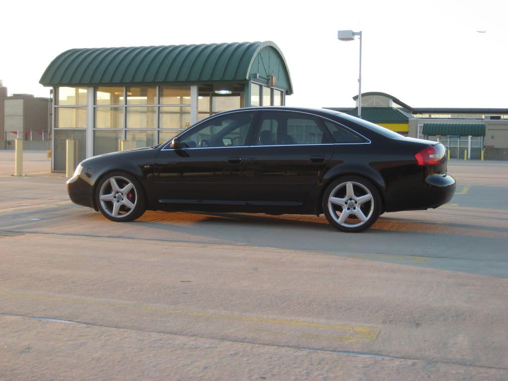

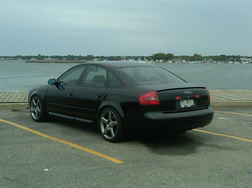

    2000 A6, narrow body.
    BBS RC. 18x8.5, et 32 (iirc). Not sure on tire size. Eibach sport springs, bilstein shocks in front, stock in rear.
    Hartmann LM Replicas. 19x8.5, et25 in front, et 20 in rear (both with spacers) 235/35/19. Eibach sport springs, bilstein shocks in front, stock in rear.
    B6 A4 wheels. 17x7.5, et 45. These are my winters, but the tires pictured are pre winter tires.
    Mercedes C63 Replicas. 19x8.5 Front et30, 19x9.5 Rear et32, et's accounting for 18mm spacers. 225/35/19 Dunlop Direzzas. H&R race springs, bilstein shocks front, stock rear.
    I will update this in the spring once I get my coils on and my new wheels on. Expect more slam & more stretch on some 9" wide wheels.

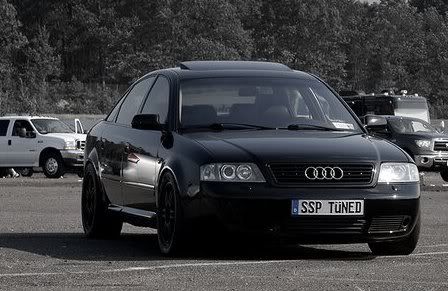

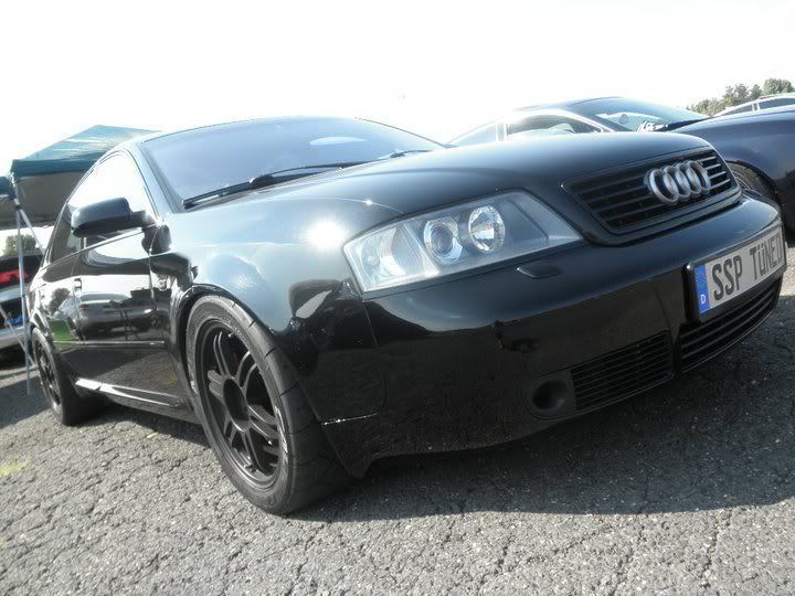

    Frank just wants another opportunity to show Wheel Whore status...
    01 A6 2.7T, blk/blk, 6MT, SSP Tuned!, 3,996 lbs w/ me, full weight, street tires, 29+lb wheels.
    Ran an 11.8 @ 119 at MIR - Sept 2008. FIRST A6 IN THE 11's!

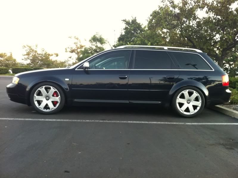

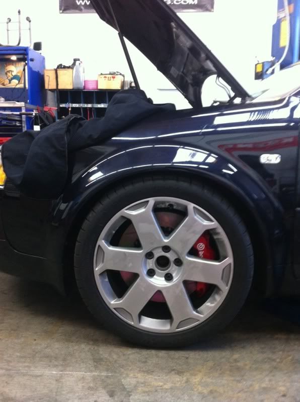

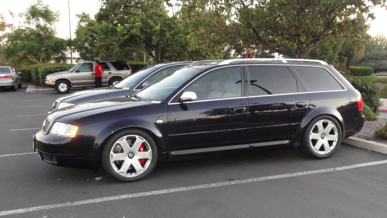

    2002 S6
    OEM B6 S4 Avus wheels
    18x8 45ET plus 22/25 mm spacers, f/r
    255/35/18
    Michelin Pilot Super Sport
    H&R coilovers
    No fender work, but they rub a bit with 3 people and bags in the car.
    The wheels easily clear 355 mm Brembos in front.
