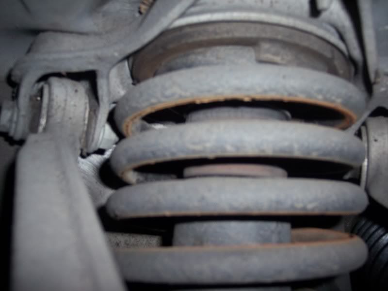

    hers a link to pictures of y suspension.

    Try prying all the ball joints to check for play, check boots and stuff and replace whatever's needed. There's also a date code stamped on the control arms which will give a decent indication of how worn they are. Also it looks like your steering rack is leaking so I would figure that out while you're in there too.

    where exactly are the ball joints (what direction would the play be?) and yea my steering rack leaks quite a bit, would i need to replace the entire thing, or can i replace that book only?
    This bushing in particular looks like it needs to be replaced?
    Oct 06 2004
    3710
    Minnesota
    That is your upper control arm. Replace the whole thing.

    Replace upper control arms and pinch bolts that hold them to the upright.

    Quote Originally Posted by A4Rob View Post
    sorry, i know its my own picture, but is that the front or rear upper control arm?
