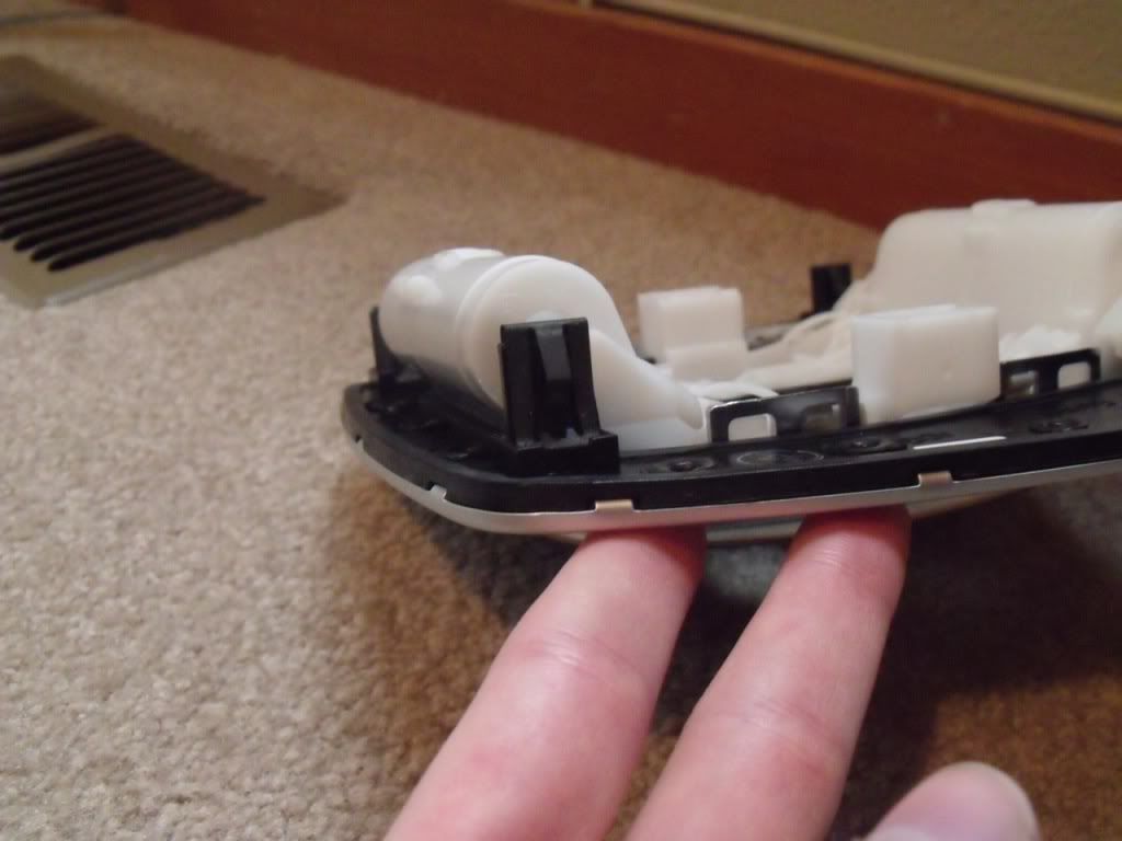

    Veteran Member Four Rings Kittrell's Avatar
    May 07 2008
    28523
    B8 S5 - 4L Q7 TDI
    Broomfield, CO
    Everyone convince the guy I just sold my trim piece to, to sell it back, and I'll do it.
    The top piece serves two functions. It houses the roller door that moves with the shifter, which also functions with the LED panel to light your way. I found out with everything removed, it works almost great. No CEL or anything, though it might produce a code with the panel disconnected. If you pop it over into manual mode, you lose your cluster indicator. It just blocks the whole thing out.
    You can shift through everything else fine, but as soon as you pop it over, it's done. Then it stays that way until you turn everything off and start over again. If you plug the LED panel back in, this does not happen.
    So if the blocked out indicator does not bother you, then you can remove it all. If it does bother you, as it does me, you will leave that part in there. I will drive around with everything disconnected this week to test it out, but I do not foresee any issues.

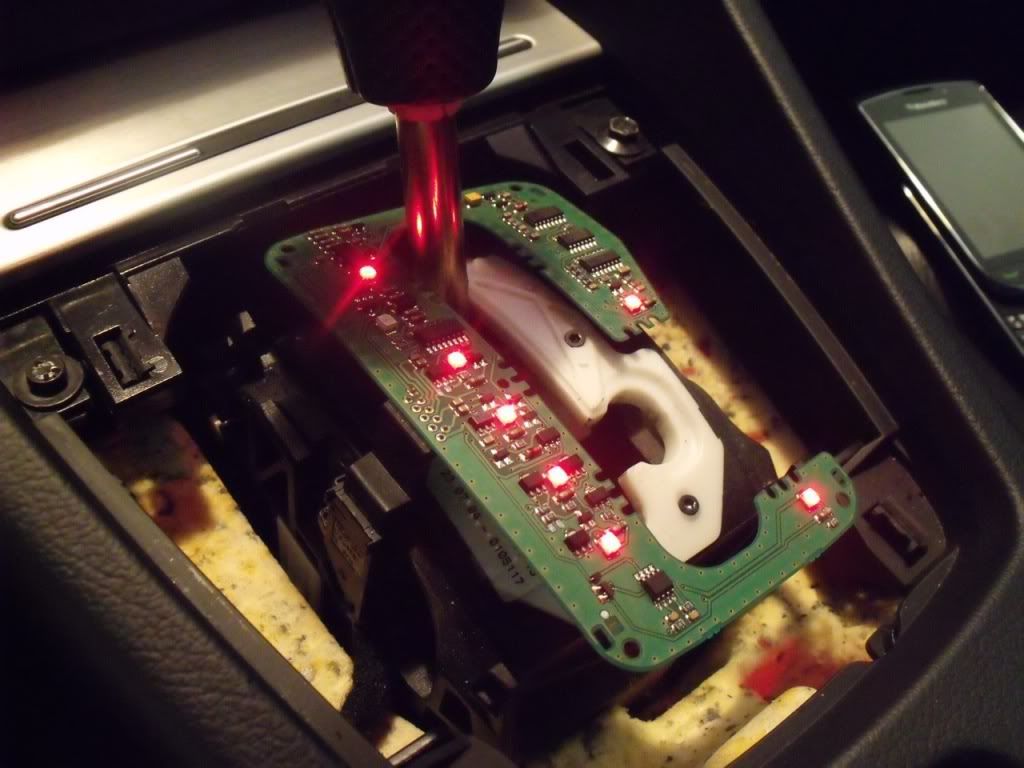

    Jun 30 2008
    30427
    Erie, Pennsylvania
    I don't think it's just a "blocked out indicator". I'm going to bet with that thing unplugged, the "Tiptronic" function (+/- gear selection) does not work at all. The magnets which trigger the switch into the Tiptronic position, as well as the + and - positions are inbuilt to the plastic slide beauty cover piece. Without this in place, manual control of the gears in Tiptronic mode, even with the steering wheel controls will not be possible.
    Not to be a buzz-kill or anything. I think you guys should get creative and figure out a way to make it happen.

    The blocked out lighting only happens with the LED panel unplugged. It does not occur with the panel plugged in, yet without the magnets. Like I said, I am going to drive around this week and see if I run into any issues.

    Jun 30 2008
    30427
    Erie, Pennsylvania
    Quote Originally Posted by Kittrell View Post
    Correct. With the panel unplugged, it notices the shifter fault right away and gives the funky position display. With it plugged in, it just won't ever know that you flipped it into Tip mode, so that mode will simply be inoperable. But certainly try it out and see what you get.

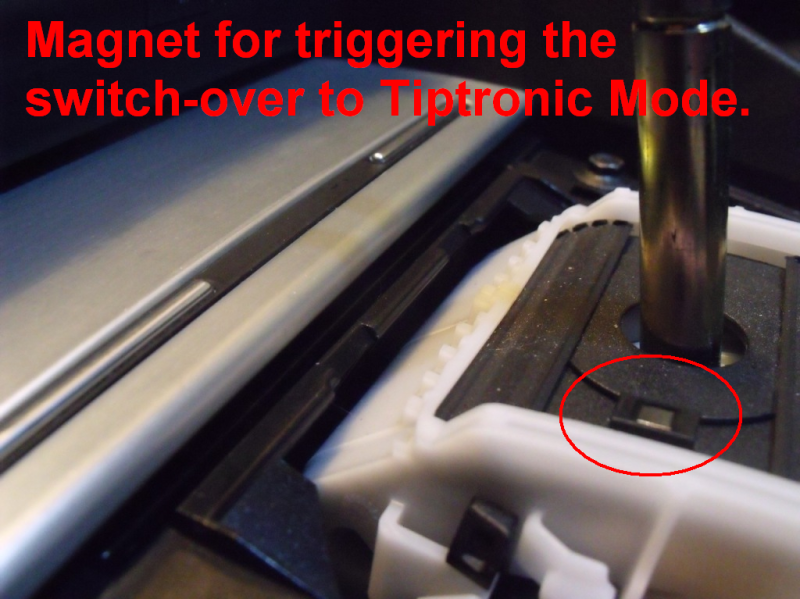

    Veteran Member Four Rings widgget's Avatar
    Dec 18 2007
    23464
    nj
    walky is right, the part part you removed has the magnet in it, without it the + and _ tip functions wont' work.

    Looking at this picture, if you remove all the tabs that jut out around the bottom edge, the hole opening would be bigger than auto shifter:
    Close up of the tabs, grinding them off should not effect fit of the part:
    However, looking at Kittrell's photos, I believe the top and the bottom of the mounting hardware is going to be a problem, since it hugs the bottom of the shifter:
    I think the sides will still fit okay, as long as the tabs are ground out.
    I'm pretty sure there is a plastic ring around the bottom of the shift boot. If this is the case, you might be able to cut off the top and the bottom of the mounting hardware, and still attach the boot ring to the side hardware and have everything still fit okay, it would just be a little loose on the top and the bottom.

    Okay, small amount of progress. Finally found a trim piece cheap enough to not worry about cutting up.
    Fully assembled
    Less chrome bezel
    Less roller door (flush)
    You can see that the more you take apart the easier this is. With everything removed it fits in there, it is still tight and you have to give it some love for these tabs to clear, but it fits. The boot looks like it would clear here. I have one, just did not want to squeeze it past those clips more than once. You would have to notch the boot frame at those clips, one each side, but it would fit. Now obviously here you lose manual functionality.
    With the bezel on there I think you would have to trim almost too much to make this feasible. So I believe the best route is to trim to fit with the roller door. You need those magnets for the manual mode to work. The chrome bezel is just a finishing piece, it serves no real purpose other than to house the board and LEDs. My Dremel of 10 years finally gave up the ghost, so I need to pick up a new one. Also school starts back on Monday which I attend full time, as well as 20 hours a week as a design engineer. So it is going to get real busy, real quick around here. Do not expect many updates, if any at all, until December.
