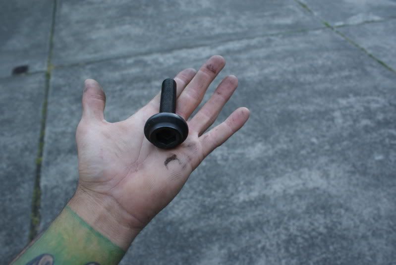

    the V-10 12 point socket is the only "special tool" required for this job. here's a (terrible) picture in case you don't know what it looks like.

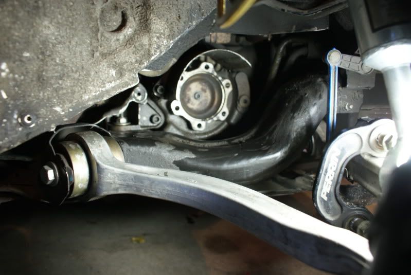

    there are six V-10 12 point bolts holding the inner cv flange to the transmission. I positioned the axle so i could remove three bolts at a time. after the fist three were out, i jacked the other front tire off the ground and spun the axle so i could get at the remaining three.
    after you wrestle the inner flange bolts out the axle is free from the car. slide the outer cv joint out of the wheel bearing assembly, and carefully sneak out the axle.
