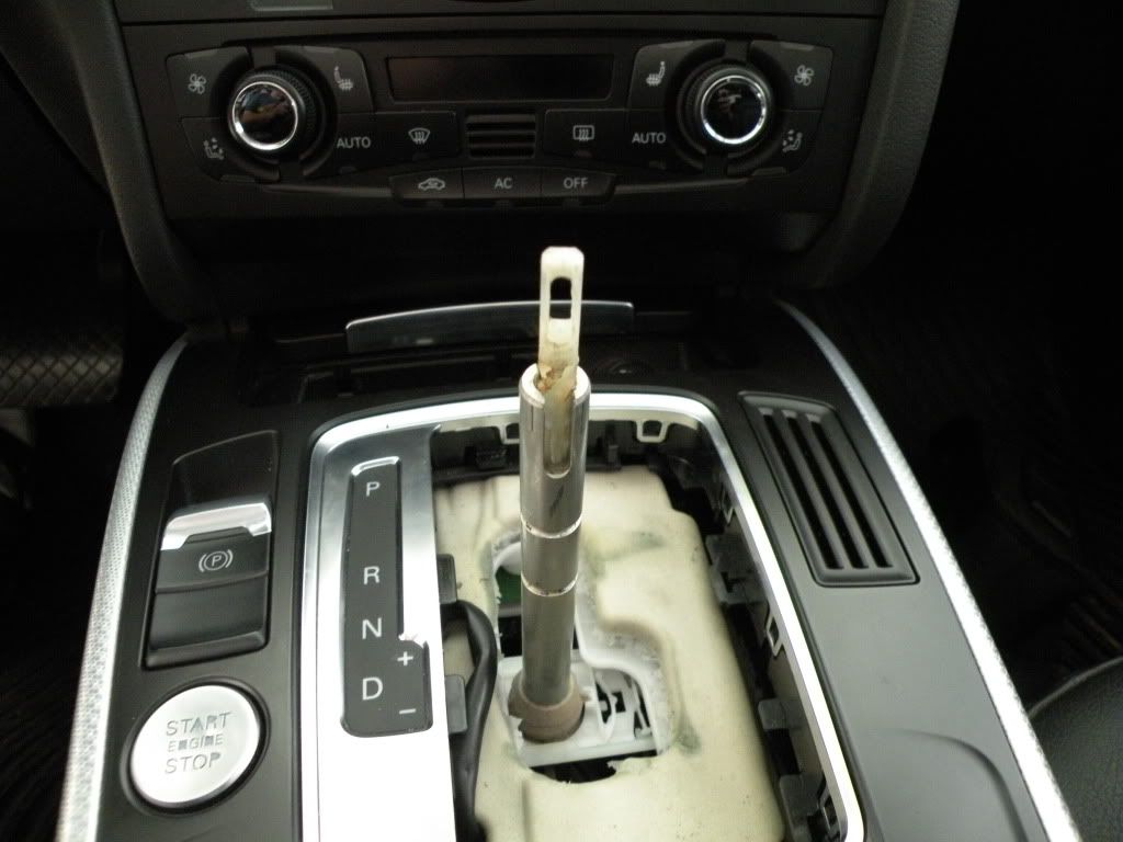

    3. Pull the shifter trigger out, its under spring tension, pull it out far enough so you can slip a zip tie through it.
    4. Pull the boot over the knob, you will notice a metallic clip wrapping around the boot, remove the clip. Its a pain to get off, i ended up braking it off to remove it.
    5. At this point you can remove the original knob and boot. Just give it a good upwards pull and it should pop right off, mine released easily. DONT PRESS THE TRIGGER while pulling up, it will fuck up the knob internals.

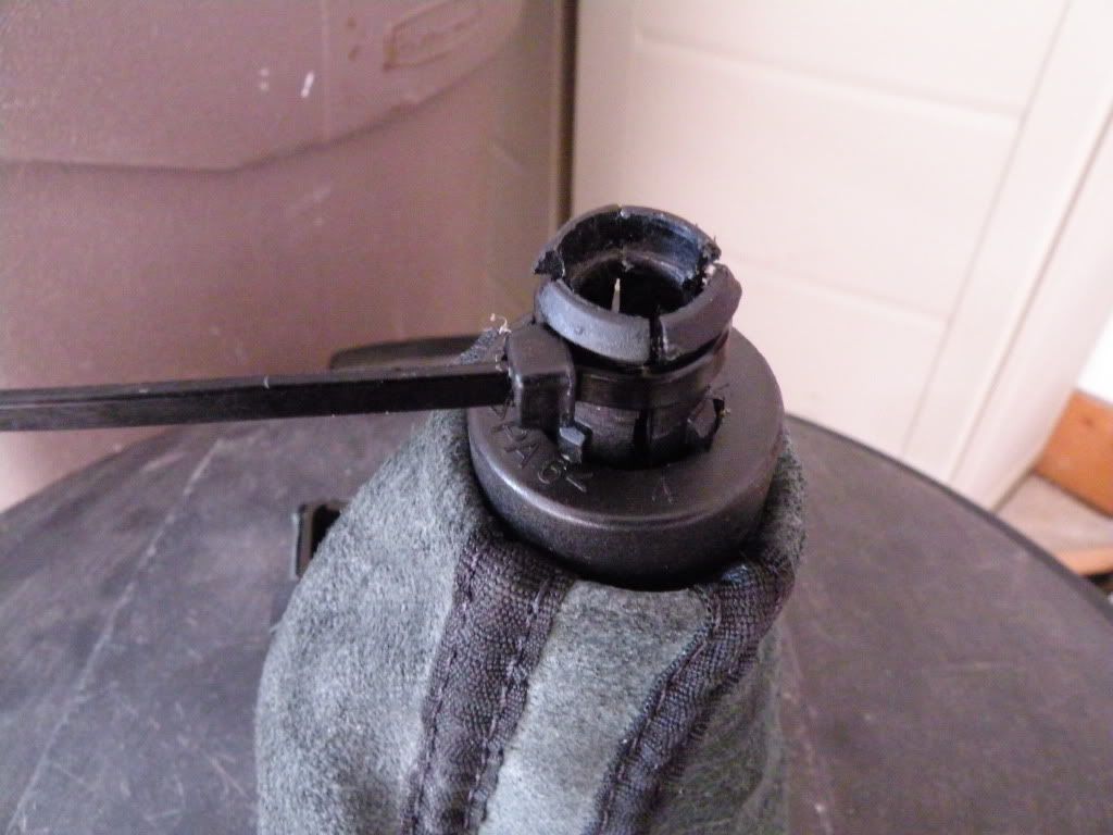

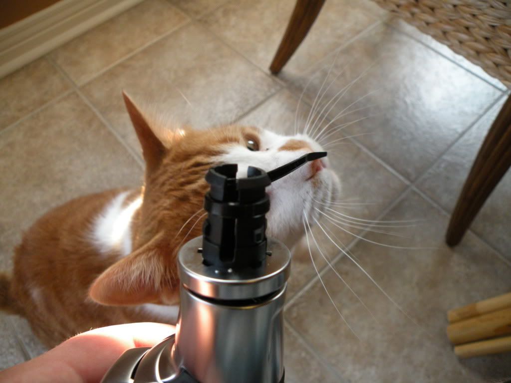

    6. Now the dicey part, as you will notice the S-tronic knob has its pull trigger at the front of the knob, while the stock one's located on the left. To make the s-tronic shifter compatible, you must heat up the white plastic shift stock and rotate it 90 degrees. I used a heat gun to heat the plastic. Take your time doing this, if you don't have enough heat you will snap the stock, and to much heat will deform it.
    7. Allow it to cool, this is a good time to transfer you original boot to the new knob. I used a zip tie to bring in the plastic tabs, they are a retainer to hold the knob in place. Youll have to do some force to pull it apart. To install the new knob onto the boot just reverse the process and make sure it is seated in all the way.
    8. This is a side step because of a problem i ran into. When you heat and twist the plastic stock you will create burs. This will cause the plastic stock to get caught up in the shifter and your trigger on the shifter wont return. I used medium grade sand paper to smooth out the stock, and a small file.
    9. To install the new knob, just reverse these steps. I replace the broken metal clip with a zip tie, works fine(step 4)
    Note: When you initially press the new knob onto the stock, make sure you are seated all the way, take note how far down from the original knob. Once its seated you can pull the trigger, this is to set the latching mech, make sure you can press the trigger and have it return on its own. If it does not return all likely hood is that you need to do some more sanding, but if you have to remove it again DO NOT FORGET to insert a zip tie under the trigger like with the original removal.
    It was an easy install took about 40 minutes plus all that other bullshit i put myself through by pressing the trigger pre install and then burs on the stock, so hopefully this will help others out there
