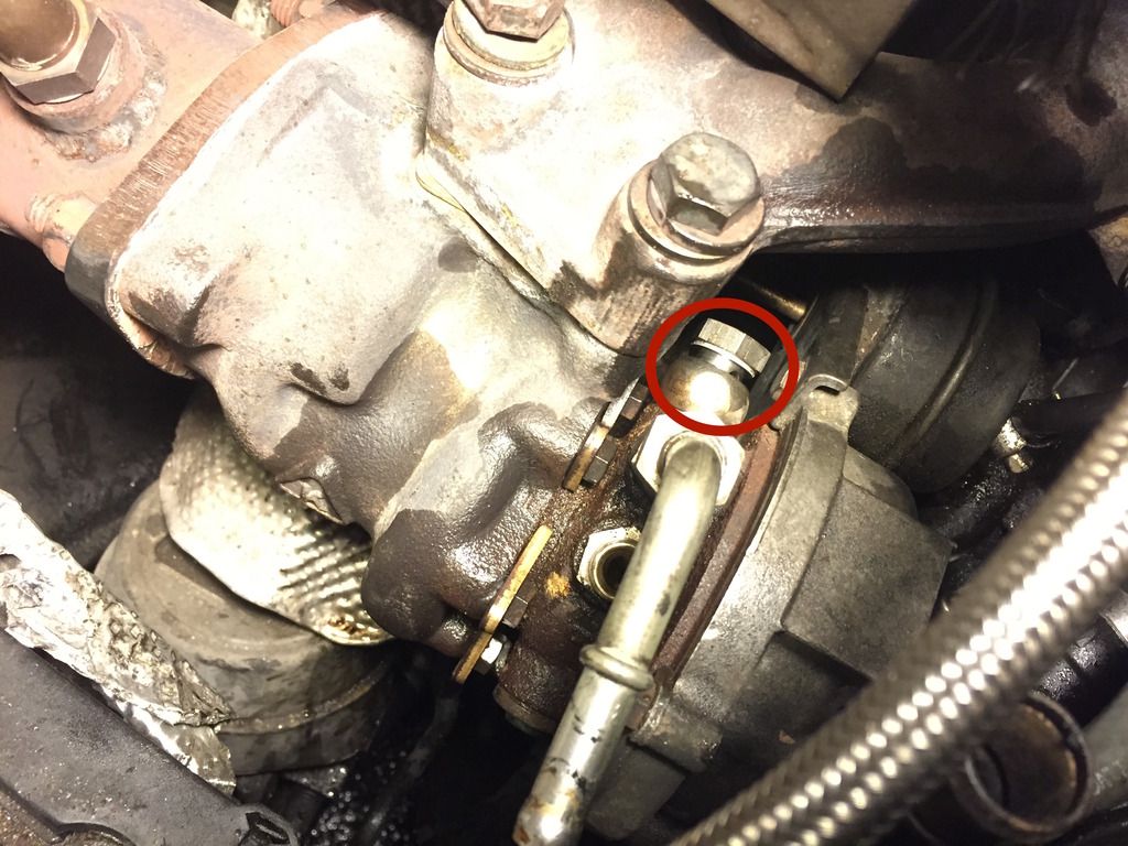

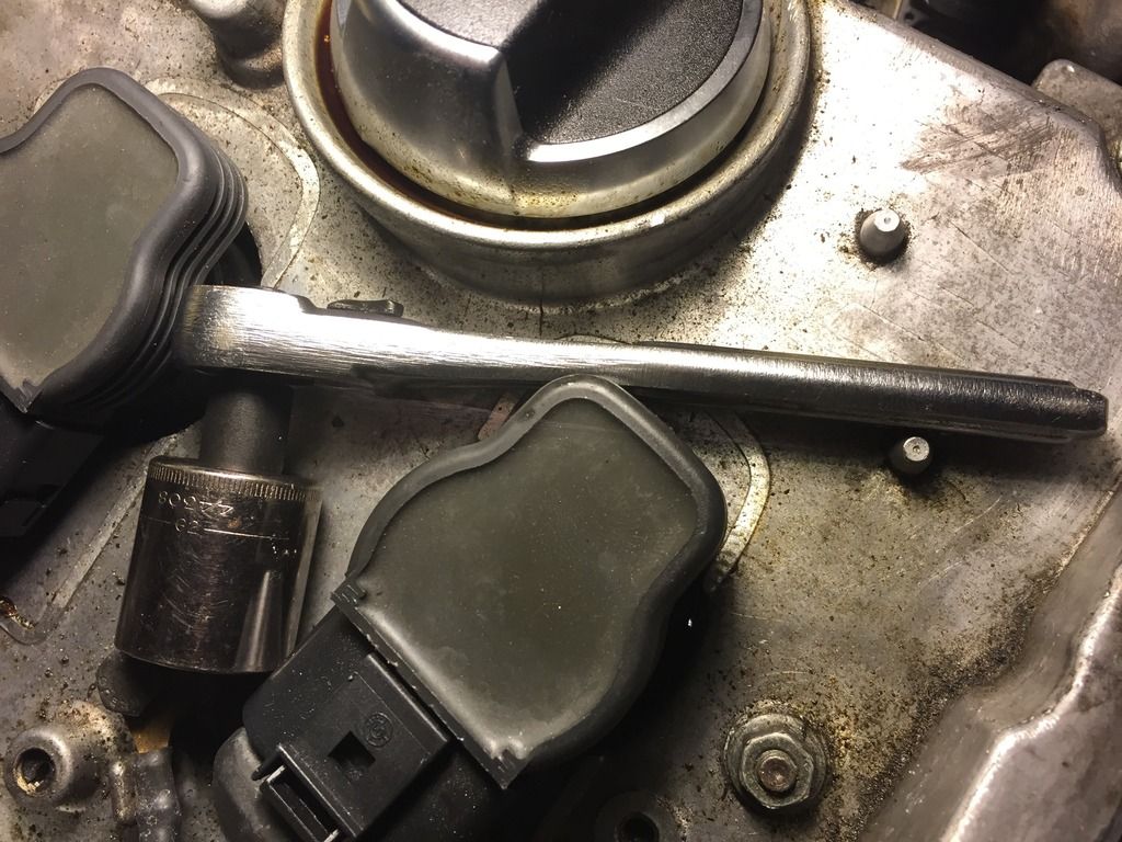

    I just wanted to update this thread to say how I was able to get the hose off with out pulling the turbo. It took quite a few different combinations before I was able to find the right one. I ended up removing the oil and coolant lines attached to the turbo trying to figure out how to get to the bolt but I think it's unnecessary with this combination. For the top banjo bolt I used a 1/4" ratchet with a 1/4" to 3/8" adapter with the socket on it(I believe the socket was 19 but that's easy enough to figure out). I used the adapter in this kit. For the lower banjo bolt I took removed the bolts for the helmholtz resonator(boost reservoir) but l left the hoses connected. That was enough to have a view of the other banjo bolt. I used the allen socket with a swivel and a couple extensions to get it off. That was the easy one. Make sure you replace the crush washers on both sides of the banjo bolts when you remove the banjo bolts.
    This is the bolt in question
    Here is what worked to get the bolt out
