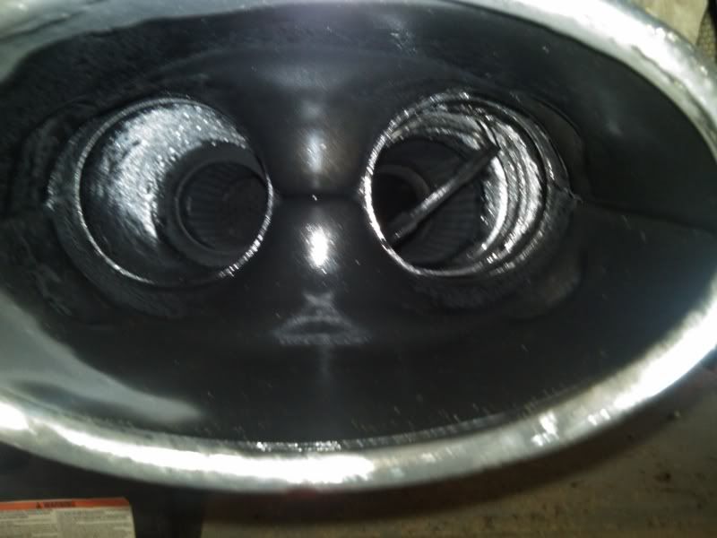

    Details: The valves open when the car is off, and are operated by vacuum lines that connect under the car, in the rear, near the exhaust exits. With the car off and the valves open, if you remove the vacuum lines, then plug them so you don't lose any vacuum pressure, the valves will stay open and not close when the car turns on. Attached are pictures of the valves open, and of the valves closed.
    Valve Open:
    Valve Closed:

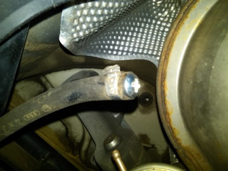

    Step One: Locate the vacuum line and pull it off. They are located near the rear of the car, right where the exhaust comes out. You'll see a cylinder type thing with a black hose coming off of it.
    Step Two: Use a short screw and screw it into the end of the black hose. Tuck the black hose into the rear valance so they aren't flopping around.

    I actually just did this same mod recently, but I used plastic clamps that just crimp the tubing, and left the lines hookd up to the mufflers. That way I can't get a vacuum leak, and in 5 seconds, I can pop the clamps open without any tools, and quiet things back down if I choose.
    I performed this mod for 2 reasons; First was because even with the S button pressed, the flaps still close in certain ranges of the RPM band to comply with euro sound regulations. The second reason is because in many situations, like city driving, I don't like the jerky throttle response the S button gives you.
    Nice job with the pics, but the only things I dont like are that you used a screw to plug the lines, and that it looks like you reused the OEM clamps. Threads on a screws can let air leak by, creating a vacuum leak, and a loss of power. Something solid with a smooth finish will create a better seal. I think a few guys even used Golf Tee's to plug those lines.
    Those clamps are really a one time use kind of thing, and wont tighten enough if reused. I picked up some hose clamps at Home Depot for less than a dollar a piece that get the job done, and are reuseable.

    I used screws and have had no leaks for almost 2 years. I also used electrical tape to cover both the screws (for a better securement) and to close up the actuator nipples to keep then clean from debris... I also suggest zip-tieing the loose hoses behind the back valence, but that doesn't really matter...

    I work in a hospital, and the crimps came off some unused surgical drains which were going to be discarded.You probably dont have that option available to you, but home depot is a good start. The red piece you see was another part of the drain which was just a piece of plastic with a hole in one end, and a slot on the other. Sliding the tube towards towards the slotted end crimps the tube also. Since I had them, I just used them both.
    If better options are readily available, why not use them. Honestly I think a smooth nail would create a better seal. Ideally I'd use a piece of plastic, or something that wont corrode to plug the lines.

    I know this post is old, however my B7 RS4 has never really had a god exhaust note, even with the S button pressed.
    Upon checking, I've found the drivers side flap is closed all the time!
    I used oil and elbow grease to free it. It moved to the open position, but closed again on driving and stayed closed.
    So my plan tonight is to remove the hose and place some golf tees into them, gently force open the seized flap and see how it goes.

    All done. Nice and easy, almost as if Audi knew that someone would have thought about doing it.
