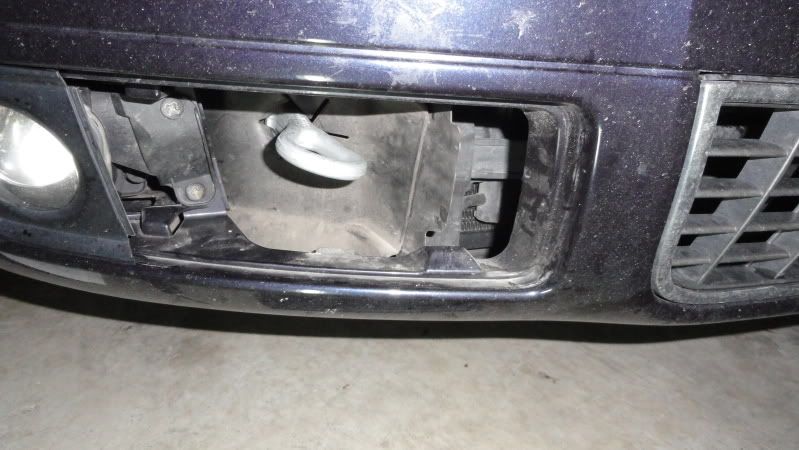

    It's behind the lower grill next to the right fog light. Once you're in there, the threaded hole is somewhere in there. If you didn't already know, the actual towing loop is in the case with your jack. Just screw it all the way in before you tow it. I understand that you can't see under there, so I'm going to look at mine and see if there's something I can use to better describe it.

    Ok, I just tried it blind, since you will be fishing around in the water. The lower grille is a pain to get off gracefully. You have to stick a screwdriver into a slot in the lower left part of the lower right grille. Push the slot in and towards the right side of the car. If your hands are in freezing water, just pry the thing out and replace it if you break it. It's kind of a pain in the ass.
    Once you're in there, there's a rubber thing with a star cut into it. Stick the hook through the hole in the rubber, and push about 1/2 inch towards the right side of the car. You 'll feel the threaded hole. Screw it all the way in, and you should be good to go.
    I'll be up for a while. Let me know if you have any other questions. Good luck!
