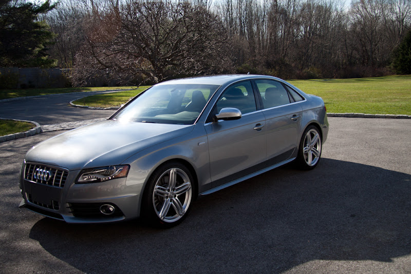

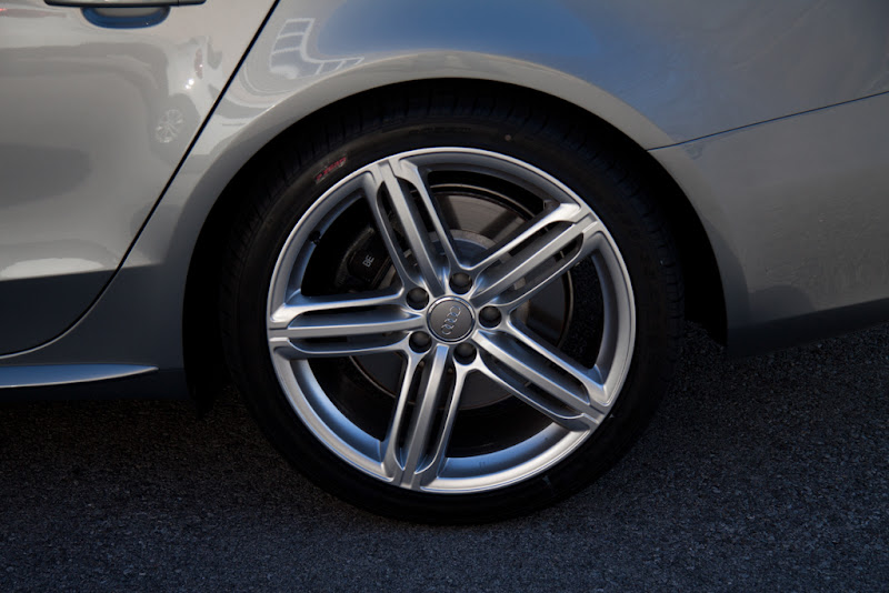

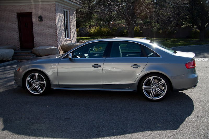

    Could be the photo, but your rear looks really high. I don't remember mine being that high even on Day 1 with OE sports. Got more pics?

    hmm...that drop looks a little off. sorry for the blunt comment but it looks stock. Maybe you should double check the springs that was installed.

    Would it be possible that you ordered the S5 OE springs instead? I've seen numerous pictures of OE springs install on B8 S4s and they are all lower than your car. Please take a look at the part number of your springs and confirm to see if its the right set. The S5 springs are an inch drop as opposed to the S4's 1.2. Not only that , the S5 springs are meant to hold a heavier car so when used in a S4 it might not drop as low as the advertised inch.

    ^^^Werd. All the pics i've seen with the OE Sport Spring setup seem to be lower than yours.

    that does look stock height. give it a week and take another picture for us.

    +1 all day. I just got a chance to check the springs and they were stamped with 29061 (S5) instead of the 50361-55 part number that is the correct number for the S4. You were 100% correct that these are indeed S5 springs, however I did correctly order the S4 springs. No idea how this happened as the invoice and the box label all stated 50361-55. Its not dangerous to drive around on S5 springs is it? I'm going to try and get this resolved by Monday but I just want to make sure I don't have anything serious to worry about if I drive it until then. Thanks again.
