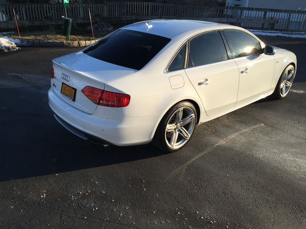

    Here's a couple quick pics:
    2012 Audi S4 | Brilliant Red/Black | Premium+ | DSG | Sport Diff | Nav | Carbon Inlays | Advanced Key | B&O | RS4 Grill | Hoen Xenonmatch Fogs | STaSIS DSG Exhaust | 18" 5-Parallel Spoke wheels/ Winter Sport 3D(winter) | Alu Kreuz | USS Sways/Ends | P3 Vent Guage | APR Stage 2 Intake |
    FOR SALE
    Established Member Three Rings LakeShow's Avatar
    Apr 26 2013
    114135
    Long Island, NY
    Those rims look great! Suit the car really well.

    S5 rotor wheels at stock height
    Established Member Two Rings WJN S4's Avatar
    Jan 21 2014
    139638
    2013 Audi S4, BMW M4, BMW X5 M
    NJ/NYC
    Looks so much better filling in the gap, love the added concave look as well.

    option is to do a replica with ET35 / 8.5" width for no rub.
    E90 M3 6MT - Melbourne Red
    (Sold) 2013 S4 - Glacier White / Black
    Senior Member Two Rings StevenStarke's Avatar
    Mar 17 2015
    320942
    17 AMS Alpha 12 R8, 22 GSXR-1000R
    LI, NY
    Quote Originally Posted by anerbe View Post
    are those as concave as oem 19x9's?
    2017 R8+ AMS Alpha 12 TT
    2015 GTR - sold
    2013 S4 6mt - sold
    2010 S4 6mt - sold
    Veteran Member Three Rings CaptSlow's Avatar
    Apr 18 2014
    189775
    NoVA
    Quote Originally Posted by StevenStarke View Post
    No they are not
