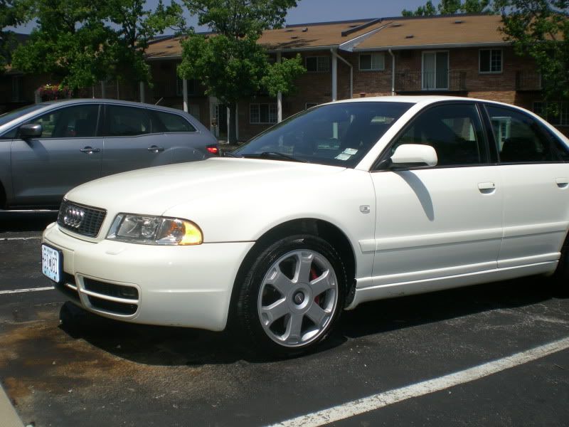

    Did a quick wash and decided to clay bar it for the first time..
    Before:
    After:

    OP - nice work.. Looks like the second picture was taken in direct sunlight but the paint definitely looks a lot cleaner. Great job.

    Thanks guys..i had my little sister clean my wheels, shine up the tires, scrub out some tar off the front bumper, and polish my engine bay with transmission fluid..all she wanted was a strawberry short cake from the ice cream truck and a dollar :]
