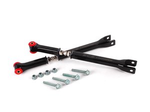

    Stay tuned for the new Stern adjustable control arms. They've boxed in the clevis for added strength. Also have a much larger weld spot at the clevis over the Gruven arms for a much sturdier design. Downside with the ends of the Gruven arm is that the threaded end is exposed and can rust over time. The rust can creep to the clevis end right at the weld where it's the weakest.
    These just wrapped up all the testing and coming this summer! Photo shows a pre-production unit with no powder coating. They'll be powder coated black.

    Got a few production units the other day..
    Pricing on these will run $249.95/pair.
    Features a reinforced clevis fork for extra durability. All steel construction for strength with satin black powder coating for protection. Stainless hardware for long term ease of adjustment. Replaceable polyurethane bushing. Lifetime warranty against defects and failures (1 year on the poly).
