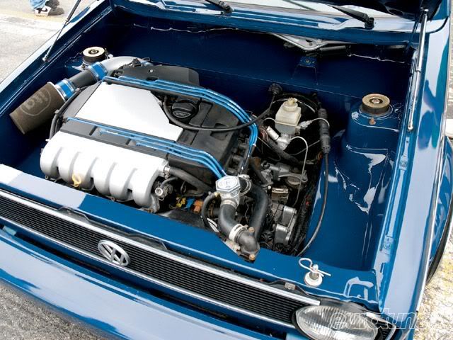

    Then how does every Vw with a shaved bay have no coolant bottle, but a Audi a4 has to have one?
    http://i84.photobucket.com/albums/k3...a/100_0402.jpg

    Quote Originally Posted by Dubdaze View Post
    you can use a small one and run it on a heater hose by the battery:
    http://i35.photobucket.com/albums/d1...n/DSCF5420.jpg
    I think everyone above maybe assumed the OP wanted to actually drive his car. If its destined to become a show car, coolant capacity is mostly irrelevant I would think. I know nothing about this though.
    By the way. Both of these setups look like ass.

    It can be done, just have to figure out the right psi rad cap to use, and figure your plumbing out
    Just quick pics I had in my photobucket

    Here's the deal looking at this pic. See the small line below the cap? That's a blow-off line for when the coolant expands. If you could trace it to its end you will find an overflow reservoir. the end of the small line will be below the coolant level in the overflow tank. When the coolant expands to above the cap pressure the coolant blows into the tank. When the coolant cools and decreases in volume the coolant is pulled back into the main system. That's what you need.
