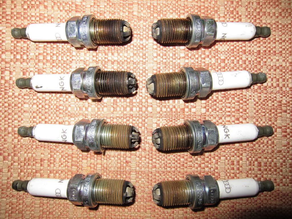

    Re: B6 s4 lack of hp?
    These are my plugs at 50k. Probably good for longer, but plugs are a cheap maintenance item to change. Car feels the same after the change, as I expected.
