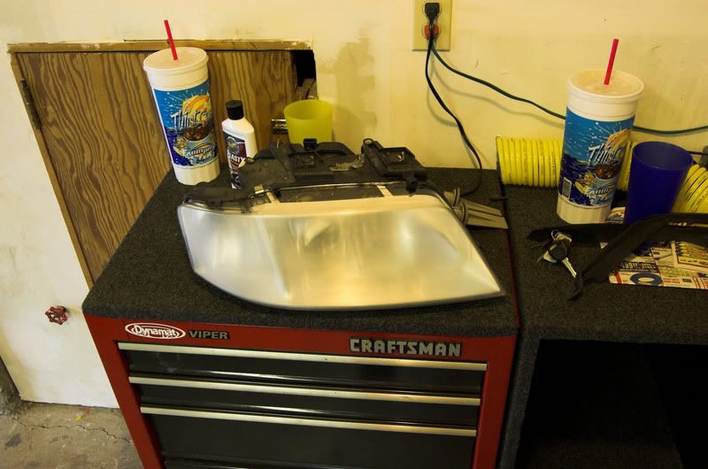

    I wouldn't use any headlight restoration kit that uses a drill. Too easy to burn though plastic.
    I did my a6 headlights the old fashioned way (wetsand with multiple grits and then plastic polished with a buffing wheel) a while ago and they came out much better than they were.
    Let me find the pics.
    -dre
    Feb 07 2008
    25012
    The boonies, near Seattle
    Re: 3M Headlight Restoration kit for Audi B5 S4
    Before -
    During -
    After -
